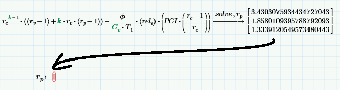

Hello all,
I would like to assign the resulting vector to a variable but I do not know how to do it.
Thank you all!

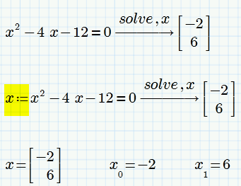

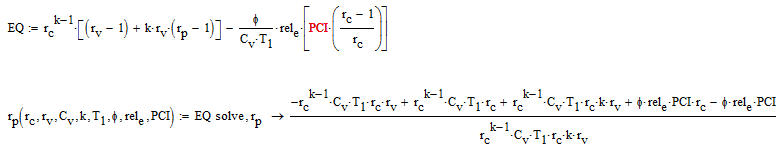

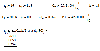

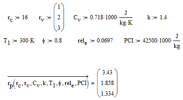

Best answer by LucMeekes
Better stil:
First solve your equation symbolically:
Then fill in the values in the variable list of the function r.p:
or:
Whichever way you like better.
April 21, 2016
simply write r.p:= in front of your expression

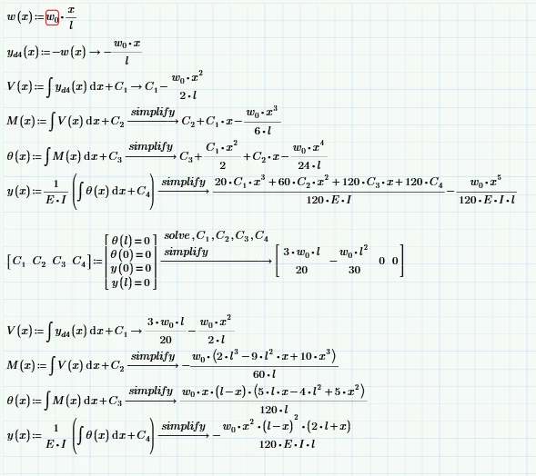

This title fits my situation to a T, so here's a new challenge that really does need to draw the symbolic/algebraic results from a symbolic evaluation out and place them into a next algebraic equation...
Here we are starting with 4 indefinite integrals that each get a constant of integration that must be solved using boundary conditions.  Then these constants need to be put back into the equations such that they can be solved numerically and plotted.
August 30, 2018
Not sure if there's a better way, but it works if you redefine V(x), M(x), Theta(x), and y(x) after solving for C1-C4:
August 30, 2018
Also, you'll either need to move the redefinitions below your value assignments, or you'll need to make all the other variables be inputs of your functions.  For example, y(x,l,w0,E,I):=...
