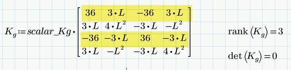

Hi everyone,
I’m implementing Lateral Torsional Buckling (LTB) calculations for beams using the Finite Element Method (FEM). My approach involves formulating the problem in matrix form, starting with the Elastic Stiffness Matrix and then the Geometric Stiffness Matrix. However, I’m encountering a singularity error when using the eigenvals function.
I’ve attached the Mathcad Prime 9.0 file for your reference. I would greatly appreciate any help or insights you can provide. Thank you!

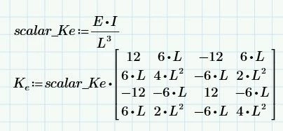

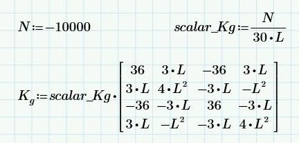

Formulate elastic stiffness matrix and geometric stiffness of 2D frame bending?
How to use the elastic stiffness matrix and geometric stiffness matrix in analysis of a 2D frame?
First how to examine the two element 6000 long simply supported beam under a compression of -10000
Note as has been pointed out this is singular and cannot be inverted.
The geometric stiffness is assembled just like the elastic stiffness into a global geometric stiffness

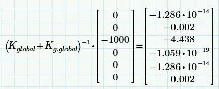

Now the combined action under the influence of the vertical point load downward and a compression inwards can be determined,
Due to the P-Delta effect of the compression applied over a sagging beam will decrease the stiffness of the structure and deflect a little more.
You can see the deflection has increased from 4.238 of previous post to a little more 4.438.

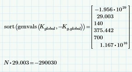

Now you can do a buckling analysis to determine how large the compression can be to buckle the beam (not lateral torsional buckling but member buckling)
Hope this helps

I have no expertise whatsoever in your field of working, but when I look at your definition of K.g, I see that the rank of this matrix is not maximal as the matrix contains dependent rows.
The third row is the negative of the first row. So regardless of the value of L the determinant of this matrix is zero and so the inverse is not defined.
That's the reason Prime chokes on K.g^-1 and matrix A remains undefined!
Maybe "geninv" can be of help!?
You may want to look at these help pages
Inverting Matrices
Rank and Linear Systems Properties of Matrices

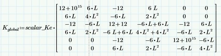

terryhendicott
Nov 3, 2024 3:27 PM UTC

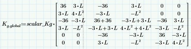

The structural model in FEM consists of discrete element stiffness matrices usually more than one assembled into a global stiffness matrix with structural restraints applied.  Once assembled and adequately structurally restrained global stiffness matrix is invertible.
Of itself the stiffness of one element is singular (third row negative of first row).

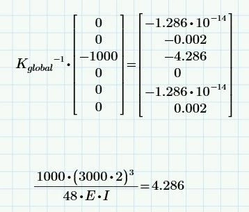

Look at a structure of two elements 3000 long.  With restraints applied vertically at each end.  Then the global stiffness matrix can be inverted.
There are two ways to handle restraints.
One is to drop the row and column of the restraint from the global stiffness matrix and keep track of what was deleted
The other easier method is to apply a large stiffness relative to the values in the stiffness matrix values on the diagonal at the correct location for the deflection/rotation under consideration.
So two elements each 3000 long with a point load of -1000 applied at the center span is:
Answer when solved is correct.
Cheers
Terry
