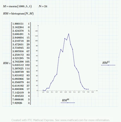

Fred,
The Prime express file with additional functions contains the histogram function. I remember working on that to make it work.
Check https://community.ptc.com/t5/PTC-Mathcad/Prime-Express-A-joke/m-p/604216.
For your example:

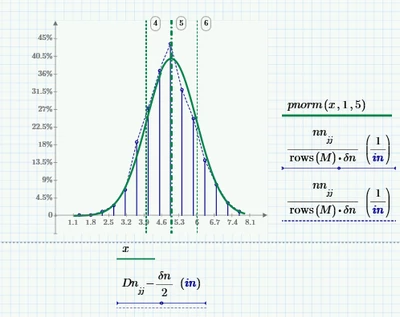

Nov 24, 2020 3:04 PM UTC
Would this help:

That looks like a great fix!

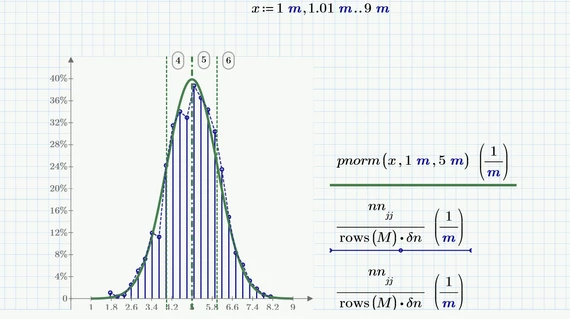

but nn and rows(M) are both simply a count.  If we have a vector of measurements with units, then dn has those units too . . .
Still works, but how do we justify the units in the graph?

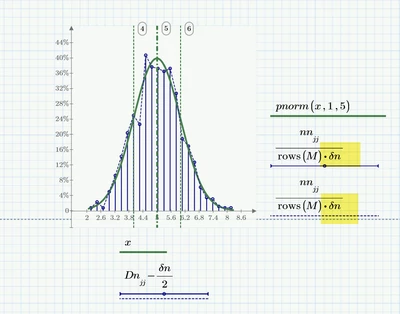

Nov 24, 2020 7:38 PM UTC
Its the necessary unit to get an area of (unitless) 1 under the curve.
You get the same unit when you use pnorm with units, too.

Fred,
For your example:

Luc,
WOW!!
I had forgotten your magnum opus.
One small addendum:  there are expressions to assist in defining how many bins you should have, seem to help.

Hi Fred,
You're right, but choosing the optimum number of bins is outside of the scope of the histogram function. I tried to mimic the functionality of the Premium function.
And I see now there's work to be done. Prime's built in histogram function accepts units (according to the help). Mine doesn't ☹️ unless the first argument is an array with the intervals specified, and also has a unit attached (the same unit as the second argument).
