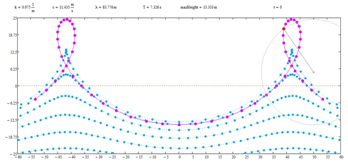

Can i form a trochoidal wave ?
Is there any way to form trochoidal wave from its equation of any values if X and Y.

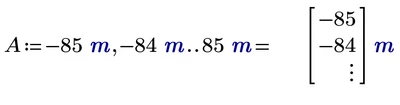

Ranges and vectors are quite different beasts bust unfortunately look the same when displayed in Prime.
Furthermore you forgot the unit (meter) when you defined A.
There is an undocumented trick to turn a range into a vector by simply immediately  evaluating it in the same region where you define it:
Now A is not a range anymore but a true vector.
A more "legal" way to define the very same vector is using a range i which is needed to index the elements of the vector.
Note that the index used is a vector/matrix index, not a literal index.

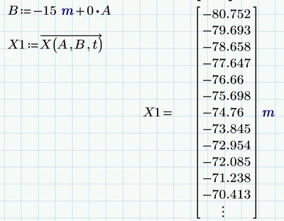

Once you defined the vector A either way, the definition of the vector B works as expected and also the calculation of the vectors X1 and Y1 (feel free to use better names):

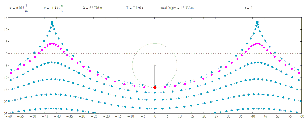

If you create five or six waves and want to plot them without individually typing in each X.., Y.. you may consider stacking all individual vectors and just use the stacked vectors XX and YY for the plot. You will see the same waves, but they form now one single trace and so you can't format them differently. This was done with the blue waves in the picture posted above.

You define  a vector  A with values equally spaced, preferably covering at least the range of lambda or more.
Define a vector B of equal size as A with values (b) all the same - you may use something like  B:=-10m+0*A  if you want to see the wave with b=-10m.
Now calculate the x- and y-values for all the particles in this wave:
Note that the function calls are vectorized (the arrow over the expression)
Now you can plot the vector Y1 over the vector X1 and its up to you to format the plot to either show only points, only lines, or both.
The last step would be to stack the x- and y-vectors for different values of b on top of each other and plot them to get what you are possible looking for.

Prime does not support animations, so Prime is only able to give you a still picture for a specific time t.
Using Mathcad 15 or below you could create an animation, too, and show, that every particle is moving on a circular path:

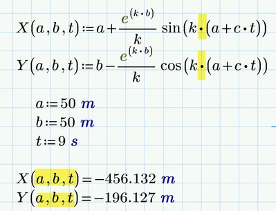

I've tried many values but i couldnt get any single particle value since units are not getting compatible.
Aug 3, 2023 11:10 AM UTC
Two errors:
1) You defined the variables a, b and t with correct units, but you call the function X( ) using unit-less numbers! Why don't you use the already defined variables?
2) You have to type a multiplication sign between the k and the opening parenthesis as otherwise its interpreted as a function k(...) which if course is not defined.
BTW, you should use negative values for b as otherwise you get trochoids with a loop in the wave crest 😉
Here you see the effect of b=+5m
My animation showed 6 waves with b-values from 0m down to -25m
With b=+50m the loop will go up to more than 600 m!
