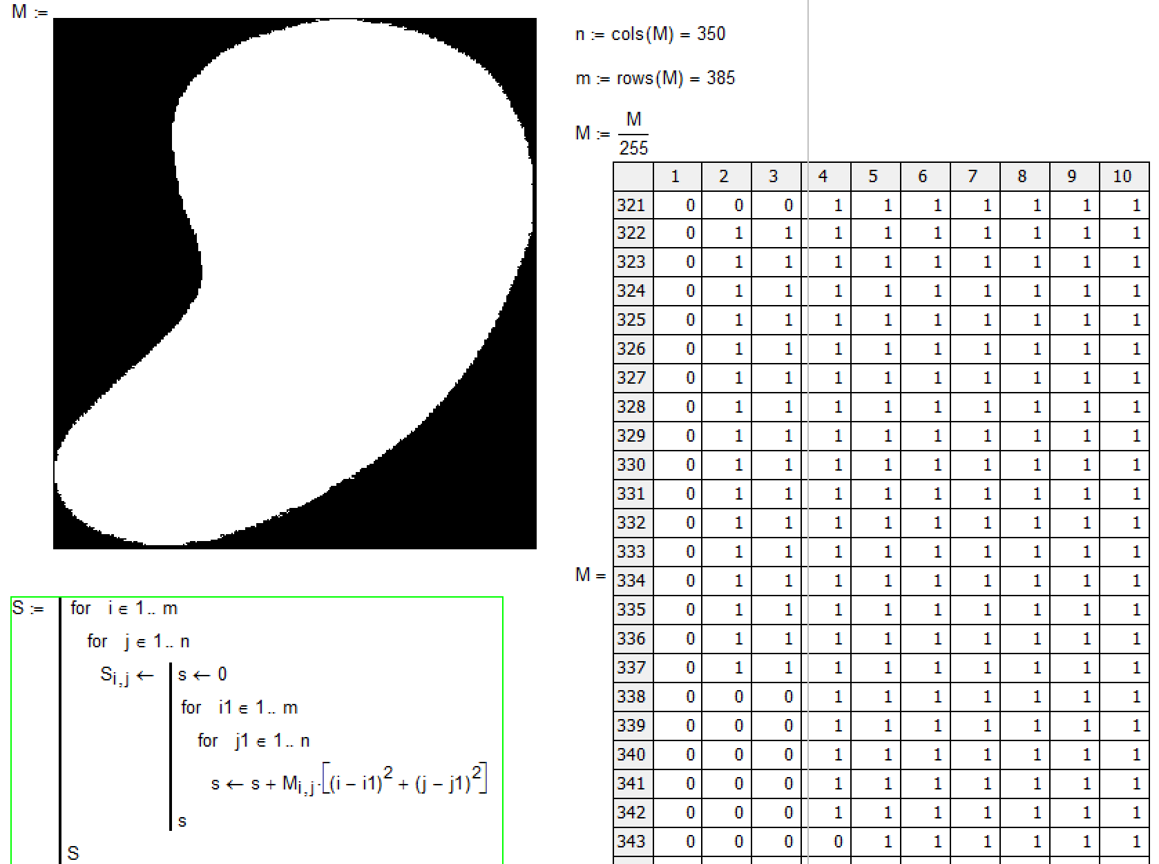

Here is how I would have approached:
Or, programmatically:
Both of these methods calculate almost instantly.
Quickly looking at your calculations, I did not follow what you were doing.  What's wrong with my approach compared to yours?

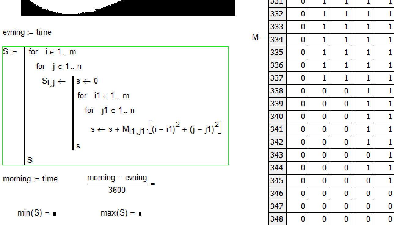

I have got the solution but it needed... 5 hr. Not from me but from my PC
Valery,
I believe you made the following error:
The matrix indices should be i1 and j1.
As a result, you found the center of the picture frame:
350 / 2 = 175
385 / 2 = 192.5
Thanks, Mark
Now I am going to bed. I will say tomorrow the resultat

You can integrate the boundary curves.
45 minutes start to finish:
Thanks, Fred!
But I see one error

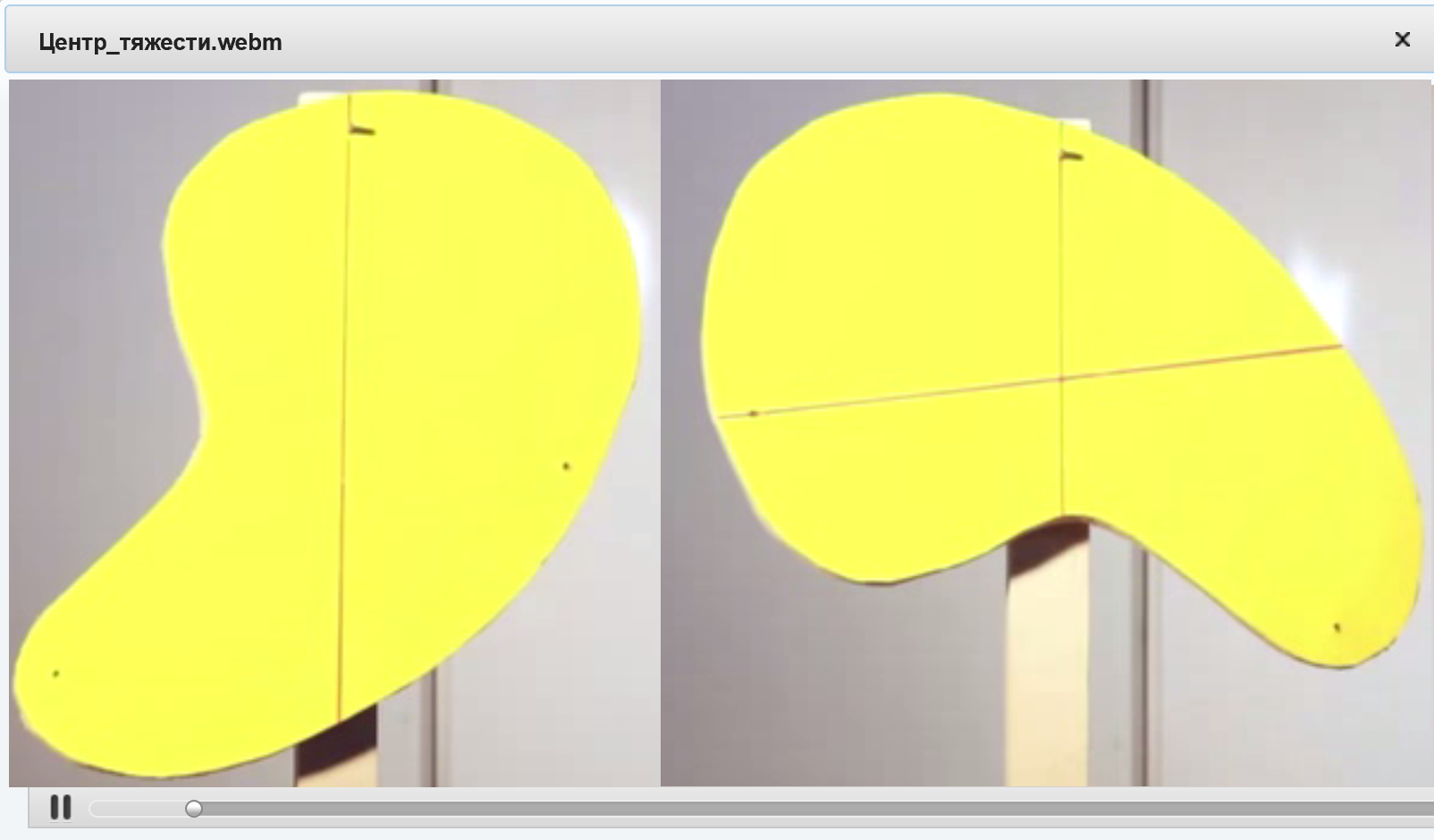

Here is another simpler approach if the area is given by a pixel graphics
EDIT: Oops, sorry. Had not seen that Mark already suggested this approach.
One check

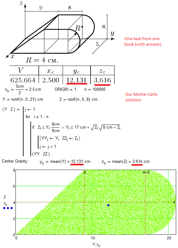

You can find CG by using our Monte-Carlo method
(from Kirsanov book http://vuz.exponenta.ru/PDF/tm2.pdf)
