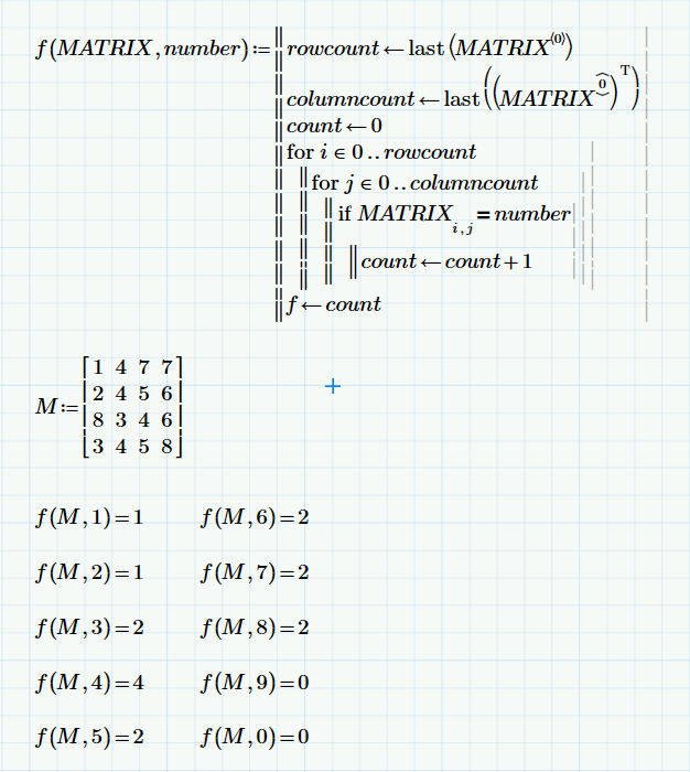

September 14, 2016
in Mathcad 3.1 I created this "thing" ...
MH
September 14, 2016
Looks like we are going to collect differnt ways and methods to achieve the same result.
So here is another piece for that collection
Guess we could also combine Stuarts "unravel" with the vector sum operator.
Nevertheless I would vote for Richards approach - nice and tidy 😉
