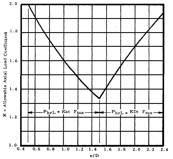

I have this graph attached below. I want to be able to just specify e/D and have mathcad spit out K. What is the easiest way to do this? Maybe some sort of lookup table? I'm not sure.
May 2, 2012
Create a table with a few basic points and use an interpolation function.
For this curve, linterp (linear interpolation) should be adequate.
May 2, 2012
I think I understand. So column 0 would be e/D and column 1 would be K. I would use:
linterp(vx, vy, x)
where vx is column 0 and vy is column 1 and x is my e/D value?
May 2, 2012
Yes.
