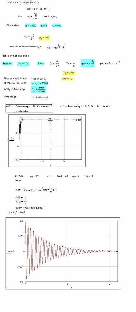

I am trying to set up the standard convulsion /Duhamel integral for a damped SDOF subject to an arbitrary input p(t) but can’t figure out the syntax required in MathCAD to make it work. Could someone help me on this one? (see attached mcad file)

I think part of your problem stems from the definition of your impulse function p.  You impulse frequency is much higher than the natural frequency  of your system, and the pulse is over very fast.  But the top illustration in your image shows an excitation imposed on a system with a higher frequency than the excitation.
Attached is an example with the same damped system, with a half-sine pulse with a frequency much lower than the natural frequency of your system.  And the integral works (sort of.)
If you had an impulse defined by data points you would have to fit a function to the data before you integrated.

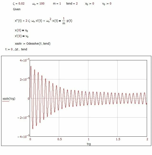

Mathcad REALLY likes units.
See if this helps

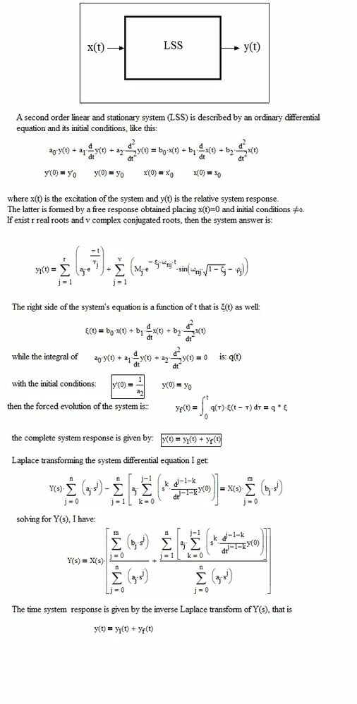

CONVOLUTION! please! You have to define x.0 and v.0

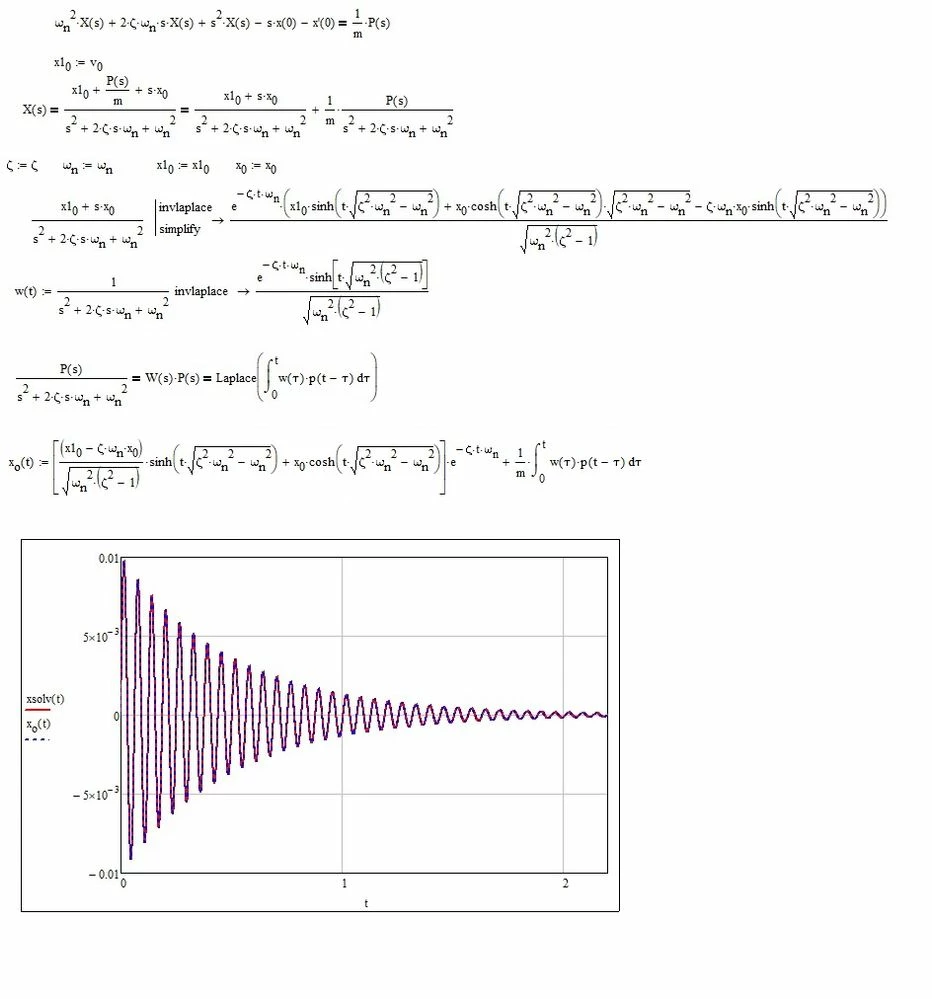

While sure Fred is right about units you see in his sheet that you have to strip out the units for the odesolve-block (one of the very few advatages of Prime is that you can use units here.).
But maybe we should explain why your attempt failed. The reason is that in your initial conditions you used x0 and v0, but forgot to define them.
EDIT: Sorry, Francesco already explained that. His reply did not show up until I posted mine.

I didn't use unit because all the inputs are consistent (unit wise) and I did notice that the odesolve didn't like units. I also realized that I used m to define the mass
Thanks for pointing the error on the way I defined the Duhamel integral

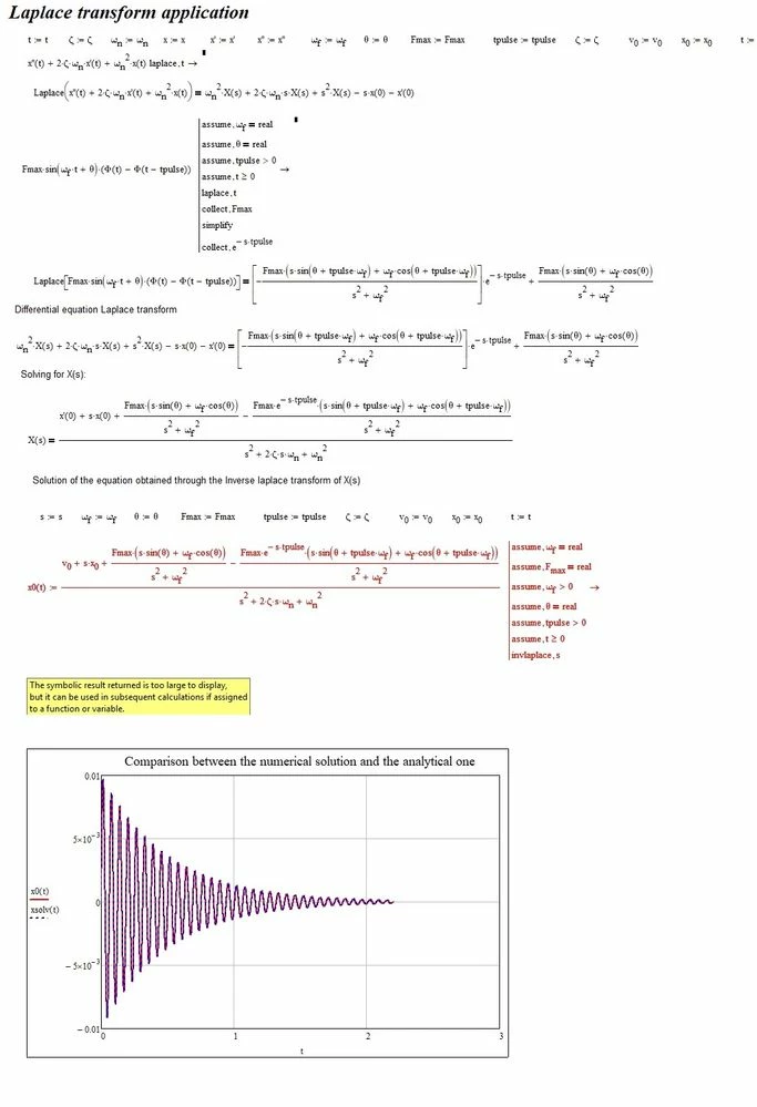

Hi JXB,
I would say that the convolution was not applied correctly. In fact, by applying the Laplace transform to the equation and then anti-transforming, I obtain a very large solution that can not be displayed, but coincides with that calculated using odesolve. See below:
Thanks for that insight. Struggling to follow the math but it is interesting to note that what is a simple academic example is throwing some "issues" once defined/set-up in Mathcad. I was simply doing some checks
