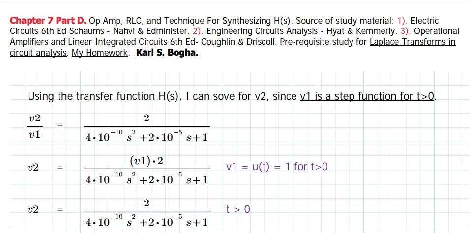

ttokoro
p.207, You must use V1(s)=1/s.
t.t.
KarlBogha14-AlexandriteAuthor
Sorry for the late reply.
I know the file  you are referring too, can you please give me the 'example number' or 'exercise number' you refer to on page 207. Since that pdf file, Electric Circuits II Part 3D, is not page numbered on the page itself, and your attached file is mcdx. That will help.
Karl.
ttokoro
Example 8.15 (Active Circuit)
v1 = u(t) = 1 for t>0, but V1(s):=1/s instead of 1.
If you use 1, it means impulse response of the system.
t.t.
