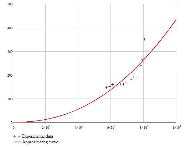

I have some data that have been obtained experimentally. I used the built-in function "genfit" for the selection of the approximating function. I took to be a form of this function like: f(x)=a*x^b. And in this case, I know that the function at the point x = 0 must be zero (f(x_0)=0). Are there any suggestions what other functions can describe the experimental data best way? Thanks.

It doesn't look from the rest of your data as if f(0)=0 but you should know better, of course.
See attached some other fit functions with two parameters.
Don't you know anything about the fit function you should expect?
I think the sorting at the beginning of your file needs some refinement.

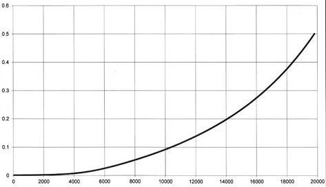

Thank you, Werner. Theoretically the approximating function should look like the figure below. Sorting data at the beginning of the worksheet is not necessary. Experimental data is read from an external file in which the data are sorted in advance.

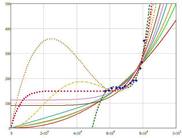

Here is a slightly improved/speeded up verson of the first part alopng with a selection of different approximations

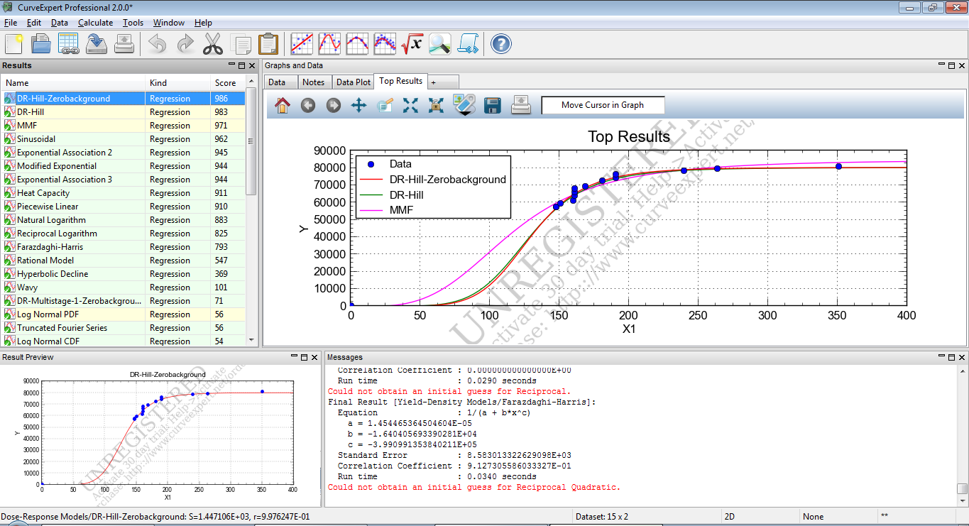

VladimirN24-Ruby IVAuthor
September 3, 2013

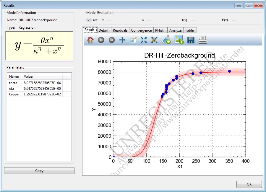

Here are the results produced by the program CurveExpert Professional for "Nonlinear Model Fit":
September 3, 2013
You get the same values using Mathcad with those two function types, but genfit is rather sensible with respect to the guess values. A solve block may find solutions which genfit doesn't.
In the file you sent you had used the inverse function, though. So you would have to plot X over Y to get the same.
See attached for more
