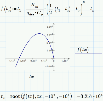

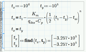

I have an equation with one uknown on both sides and would like to iterate to get the value of variable, however the find function brings error, I think I am following others recommendations (several youtube presentations) but still no result. I have more equation like this to solve and would really do with advice what I am doing wrong.

Yes things have changed since mathcad 15 (unfortunately). As find() can't be used outside a solve block, it would be a good idea if Prime would insert a solve block autimatically when find() is inserted outside of a solve block. but thats not implemented that way. You first have to insert that ugly and clumsy block and then add your guesses, constraints and a solve block function like Find, Minerr, Odesolve, etc.
Getting a suitable guess value is sometimes vital. In your case it was obvious that your system of two equations in two variables is in reality just one euqation in one variable. in this case its often a good idea to plot the function to get a visual impression where a solution is to be expected. Your expression gets complex for values of tx greater than 40, so we had to look at the negative range and zoom far out (Prime does not have a zoom option, so its a tedious job changing the plot limits manually.
I haven't used a solve block in my first attempt to get a solution but had used root(). But of course the solve block with your two variables would yield the very same result given you provide suitable guesses.

Despite your impudent reply a last tip: Chose another guess value to get a solution. After all your solution is approx. at -3.187*10^5. With guess value 0 the solve block will fail.
