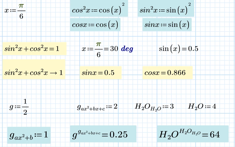

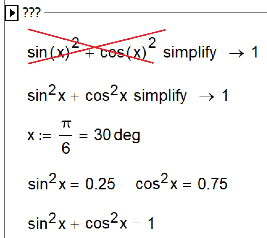

The writing of some formulas in Mathcad differs from the writing of these formulas in textbooks in mathematics.
My students have learned to partially correct this.
One example is in the picture.
Three questions.
1. Guess how my students do it! What is written in the hidden area.
2. Show other examples of such a mismatch of operators in Mathcad and textbooks.
3. What needs to be changed - Mathcad or textbooks?

And Mathcads way of showing the square of the sine and cosine is perfectly compliant with the ISO80000-2. Omitting the parentheses and putting the exponent right after the functions name is allowed for named functions which also have a named inverse (and also preferred by me in that case) but its not mandatory.
BTW, try your workaround in Prime where we don't have the comfort of the Prefix Operator 😉
To conform with the standards we would of course have to change the standard Prime display to use an upright font without serifs.
And as you ask for other examples: The usage of "log" for the decadic logarithm "lg" is wrong! According to the standards "log" is neither the decadic nor the natural logarithm but should only be used to represent a generic logarithm, e.g. to demonstrate a log rule.

sinx - without any space???
ttokoro
Feb 6, 2023 5:15 AM UTC
I can make bellow, but I can't find how to make sin x.
