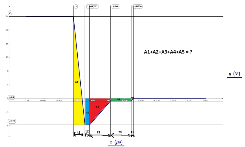

How to calculate each colored area for this graph made by points?

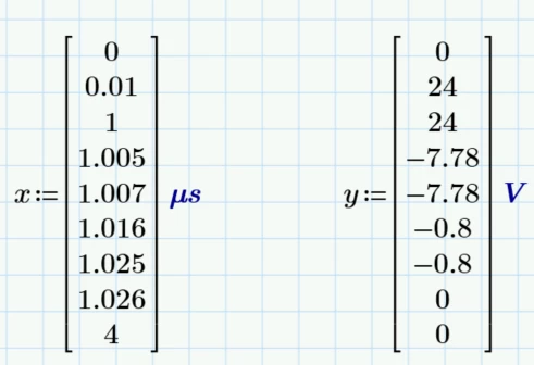

I have these points:
How to calculate each colored area from below plot made with above points?
Mathcad Prime 9 fille attached.

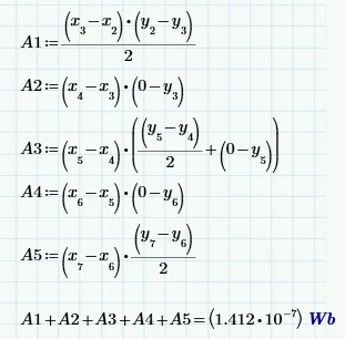

A1 is quite different from the rest so it has to be treated separately:

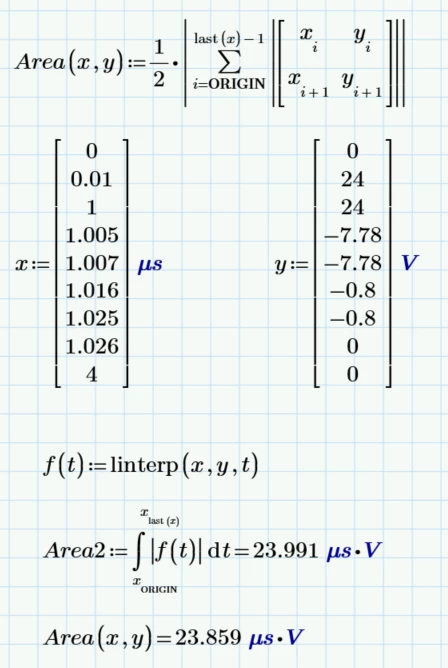

If it weren't for the weird placement of A1, you could use an integral over the (absolute value of the) function.
So what's left is brute force. like this:

ttokoro
May 10, 2024 9:46 AM UTC
Same with unit.
t.t.

Cornel19-TanzaniteAuthor
May 10, 2024 10:02 AM UTC

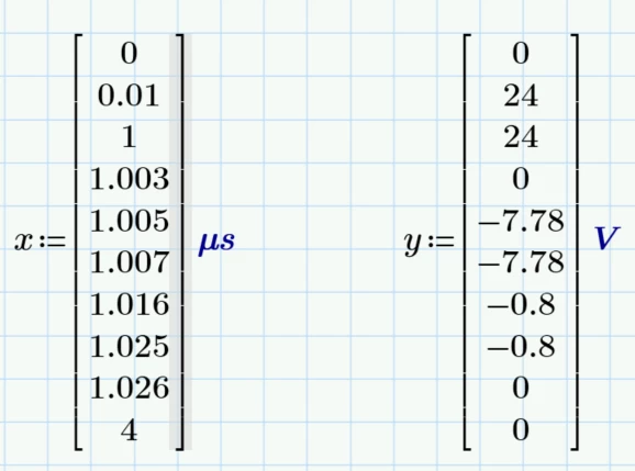

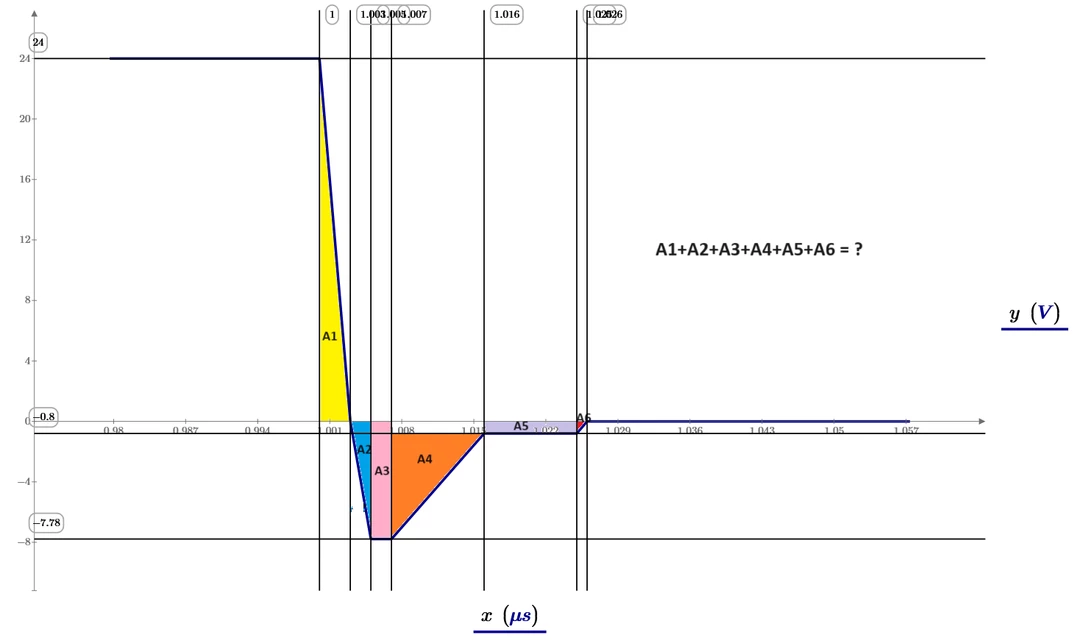

And for this?
May 10, 2024 10:13 AM UTC
@Cornel wrote:
And for this?
Are you sure about A4???
Otherwise the answer would be here: https://community.ptc.com/t5/Mathcad/How-to-calculate-each-colored-area-for-this-graph-made-by-points/m-p/948887/highlight/true#M211719

Just a thought - I'd think that since any solution is going to have the vertices known - you could then use the surveyor formula/shoelace formula to find the area.  A nifty trick Werner taught me years ago that has helped me a lot.
(OR = origin)
May 10, 2024 2:47 PM UTC
Hm,,,I to make also the Area(x,y) to give the same answer as Area2 or maybe Area3? Do not know what is the correct answer in this case..
Even if I put like that the answer is different than Area(x,y):
May 10, 2024 3:01 PM UTC
only a guess, but since the shoelace formula closes itself (i.e. back to (0,0) the negative y values act as a negative area - since the lines cross themselves.  But if you define A1, A2, etc as unique closed areas of vertices those areas should give the same values as integrating or other geometry.  Since you have a mix of triangles and rectangles and others, this one formula will suffice once your have the vertices defined.
