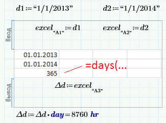

Best answer by AndyWesterman
If you need to write it into a program then you may need to write several components to do it.
First (as attached) you can convert the string date, assuming a standard format, to day month & year in numeric format.
Second will do the 'subtraction' but it will need additional statements to tidy up over & underflows on days & months and what happens if the years difference is negative.
Might not be an issue for your specific instance but could be a useful addition to a function library.

Hi walter,
See attached, hope it helps
regards
Andy
November 26, 2013
Andy,
thanks, but how can I use this in a Programm routine?
see attachment and gif pic.
thanks
Walter

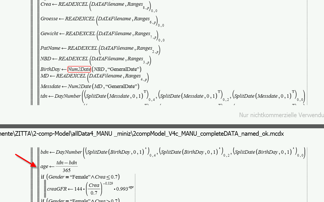

November 26, 2013
The worksheet here: Date Calendar and Time functions.mcd contains a set of functions that are not based on components. I haven't tried coverting them to Prime though.
November 26, 2013
Thanks Richard, I had this in my MC 15 sheet. But Prime does not support the VB Script component - so I think at thsi time there is no way to run it in Prime 3.0
Best regards
Walter
November 26, 2013
You may use the function DayNumber() from Richards worksheet. It does not rely on scripted components and should work for Prime, too.

It would be nice to have something like this attached MC15 sheet that accounts for leap years in Prime 3.
Norm
November 26, 2013
The leap year handling in this sheet is done outside the scripted component so you can use it as well in Prime.
The only routine which won't work in Prime is SplitDate().
Given that date usually is not given as "15 May 1980" but rather as "15.5.1980" (or "5-15-1980" in other countries) it should be not that difficult to write a Prime only routine to split.
The drawback is of course that without VBScript we have no access to the default date format of the underlying OS.
November 27, 2013
My attempt in P3 (attached) that matches the MC15 results.
I hope this helps.
November 27, 2013
Thank you very much, Norm. Now I can also calculate the years behind the comma.

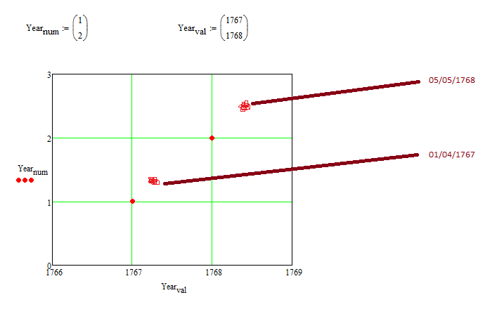

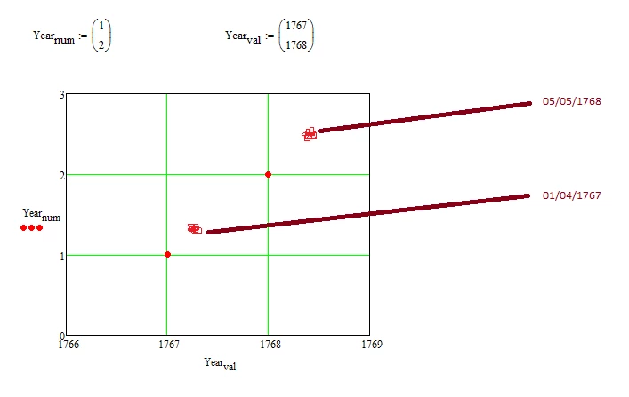

How displayed in the plot two points with dates, such as "01/04/1767" and "05/05/1768"? That is not just displayed the year ("1767", "1768"), but also to consider number of days (just a sum them to a year?).
November 28, 2013
What about the addition of the fractionofyear to 1767?
see the routine in Norm`s sheet.
