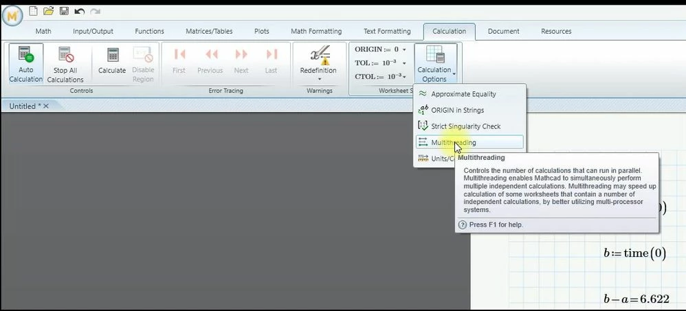

How to display calculation time
I want to know the time it takes from start to finish in mathcad14 and mathcad prime10.
Is there any way to do this?

terryhendicott
Dec 6, 2024 5:25 AM UTC
Prime と Mathcad 14.0 の両方のソフトウェアで、time(0) 関数を使用します。 これを start 変数に割り当てて 1 回使用し、finish 変数に割り当てて 2 回目に使用します。2 つの値、finish-start を減算して、ミリ秒単位の時間を計算します。 Prime では、メニューの計算 | ワークシート オプション | マルチスレッドをオフにします。そうしないと、2 つの start ステートメントと ending ステートメントの時間が計算されません。

9-Granite
Dec 9, 2024 5:59 AM UTC
ありがとうございます。
mathcad14で使用してみたところ、1つのシートでパラメータを変えて計算すると計算時間が変わります。
しかし b-a の値が変わりません。1つのシートで何回も計算するときは、time関数の引数をその都度変える必要がありますか?

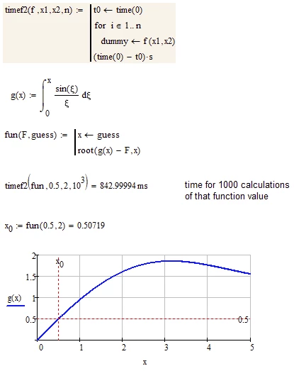

Dec 6, 2024 6:11 AM UTC
@terryhendicott
The difference is NOT the time in milliseconds but rather the time in seconds!
time(..) returns the number of seconds that have elapsed since 1.1.1970.
So using time(..) you could calculate the current date and time - we have already seen functions here which would do exactly that.
@TT_12301010
Timing using time(0) is somewhat inaccurate but the best we have out of the box. I remember that in this forum a long time ago more precise routines were posted (for Mathcad, not for Prime) but couldn't find the threads here. As far as I can remember a User DLL accessing the time stamp counter of the the CPU did the trick of a more precise timing.
Instead of timing the whole worksheet it may be beneficial to time specific functions.
Here is a generic timing function to be used to time functions with two arguments.
The arguments of "timef2" are the function name to test, the two arguments which should be used and the number of repetitions to be done.
You may also return the function result if that seems appropriate. In this case in Mathcad we cannot add the units second because Mathcad does not support arrays with mixed units, Therefore the unit seconds is just added when the result is displayed.
Prime supports arrays with mixed units so in Prime you could add the seconds already in the timer function if you like.
