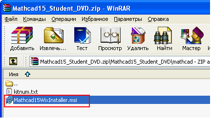

Try to start the installation of Mathcad 15 not with an launch "setup.exe", and run from the folder "mathcad" next file - "Mathcad15WixInstaller.msi":
Also, you must install the following additional components from Microsoft:
