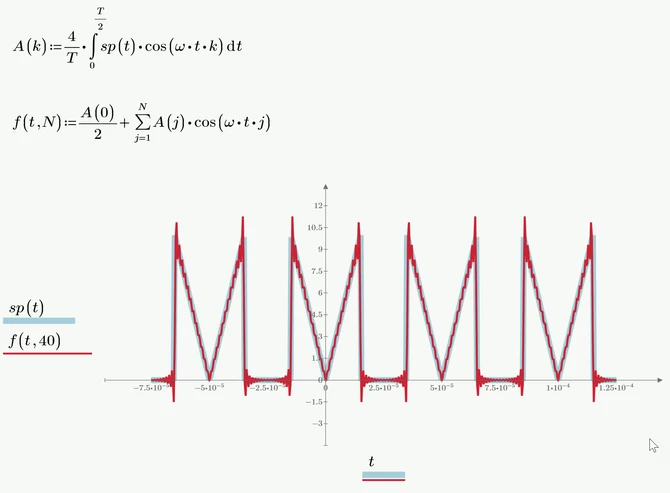

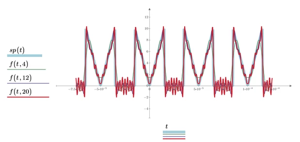

Now you can define the FOURIER approximation of the periodic signal and compare the results with the original signal.
Or even better make advantage of the symmetry of the signal (no sine wave components.
Just for demonstration I turned A into a function of k. While this may be more compact, needs no range variable and does not limit N, its less efficient and much more time consuming because A has to be calculated from anew every time f(t,..) is called.
You may also increase the accuracy of the numerical integration if you use ti as upper integral limit instead of T/2 (the integrand is now continuous).
The approach of using symmetry and to integrate from 0 to T/2 or ti works OK even with the default value for TOL.

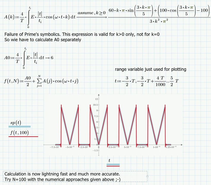

Now that we have limited the signal to one simple linear function only, we can also use Prime's symbolics (would not work using the "if" statement in the definition of the signal).
Prime 11 sheet attached

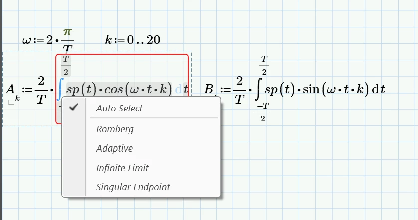

Dec 18, 2025 12:24 AM UTC
What happens if you choose an alternative integration method (I've only got Mathcad Express, so can't check)?
(right-click on integral to bring up the context menu)
Stuart
Dec 18, 2025 12:39 AM UTC
Unfortunately none of the options would do the trick. As explained above, changing TOL from 10^-3 to another value (either larger or smaller - the latter was a surprise!) cures that problem. We have seen it quite often here when dealing with discontinuities in the integrand. In combination with the quite small abscissa values involved inaccuracies and nasty round-offs are to expected anyway.
