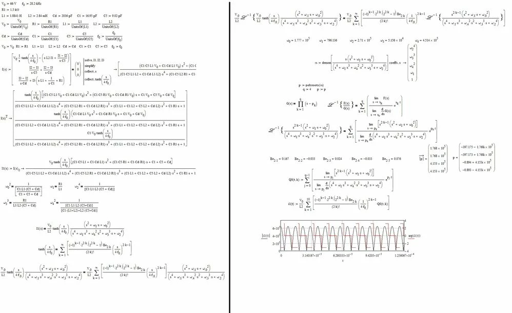

ssato15-MoonstoneAuthor
December 22, 2021
Luc san,
 The input voltage is continuous rectangular wave.
We get the laplace  transofrm from a text book.
I agree the using circuit simulator.

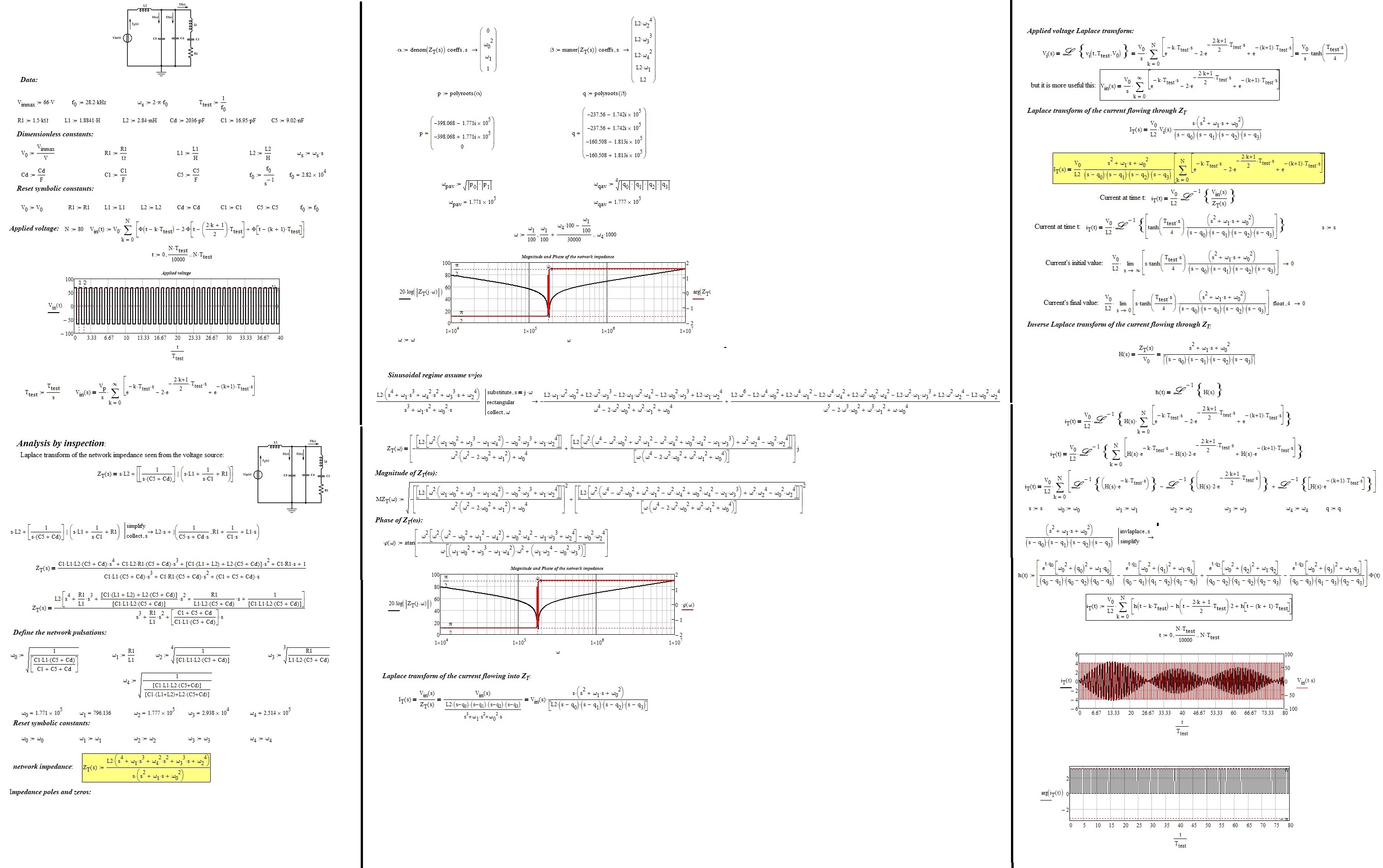

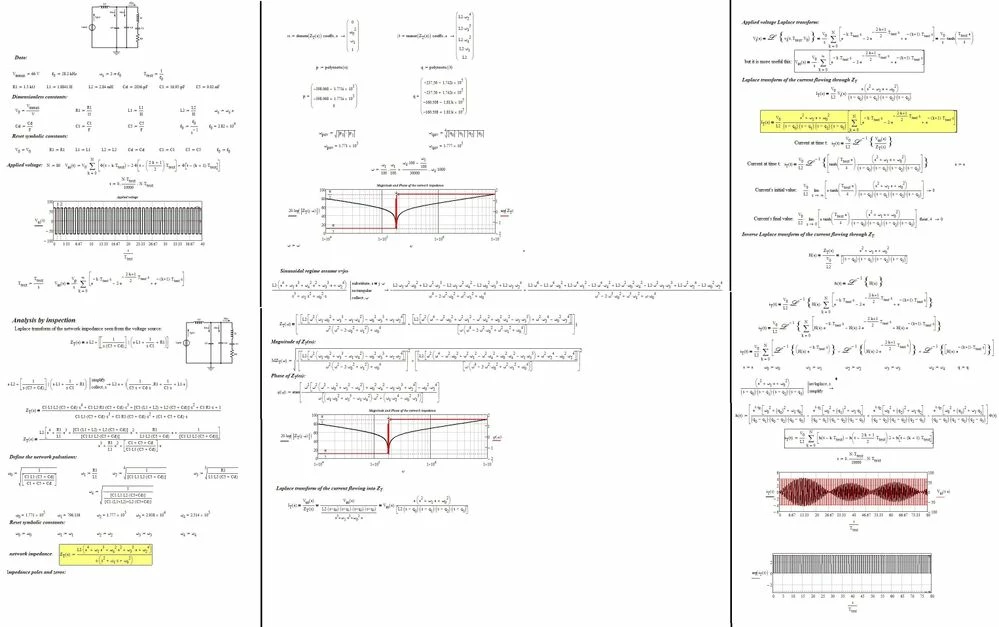

December 22, 2021
Hi!
my solution with Mathcad 15:

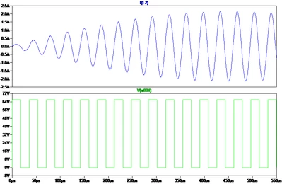

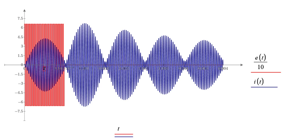

December 23, 2021
If I'm not mistaken, this your circuit:
(L1 is quite a large inductor)
This is I1, the current in L2:
Appears to increase to a steady amplitude, but look further:

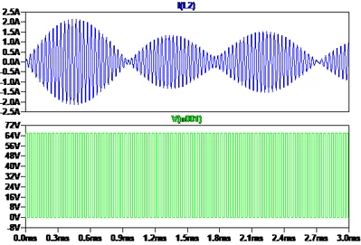

And in the long run, the first 20 ms:
And up to 200 ms.

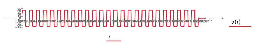

ttokoro
December 23, 2021
Magnitude of i1(t) is different but the shape is almost same by Prime 7 for 25 cycles of applied voltage with +-both sign applied.
December 24, 2021
Hello Luc san, ttokoro san,
I attempt your method what is to describe my input wave form for just a few cycles of the square wave
I attached the work sheet. Almost is OK.
But I think the polarity of the only first cycle is reversed.
The polarity of waveform attached by ttokoro-san looks correct.
Is my wave form is correct , or do I have a mistake ?
December 24, 2021
Hi!
Taking the cue from the circuit provided by LucMeekes and considering I1 as the current produced by the generator, I made this analysis of the circuit by inspection. The results are:

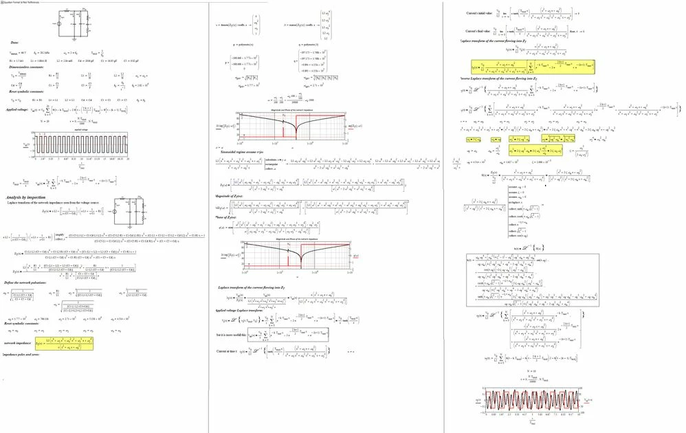

December 25, 2021
Improved solution:

December 25, 2021
Dear MFra,
Your last equation h(t) has no Unit step function, USF
I think step voltage responce must have USF for every switchuing time as at first Luc shows us.
Because this transient responce is a convolution of Voltage signal and the inpulce response of the system.
t.t.
December 25, 2021
thank you very much, I corrected the original.
