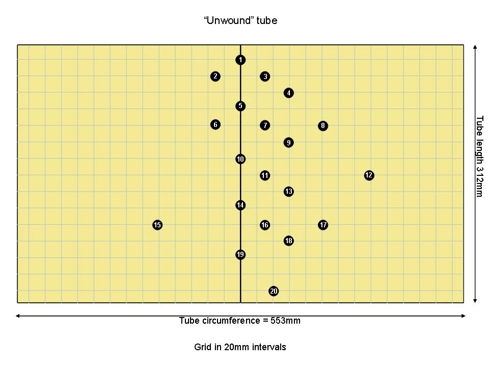

Just returned to this thread, and realise I probably didn't make the problem clear. I didn't really want to get into a discussion about calibrating thermocouples - I was just trying to set the scene. Anyway, my thermocouples were arranged as in attached file "thermocouples 2.jpg". I interrogated the thermocouples 4 times a second for 100 seconds and have generated an animation - see attached "EC71 thermal.wmv".

First I discarded the thermocouples on the left of the centre line as shown on the map I posted earlier - these were for redundancy.
Then I created a 15x16 matrix and mapped the values I knew onto the relevant positions.
Then running along each of the columns with data in, I filled in the missing values with linear interpolation - I then ran along each row and linterp(ed) the missing values again to fill the empty columns. I had to tidy-up before the first and after the last point in each line as linterp starts extrapolating and was giving silly results
Finally I generated a mirror image and stuck the arrays together to create the symetrical pattern
