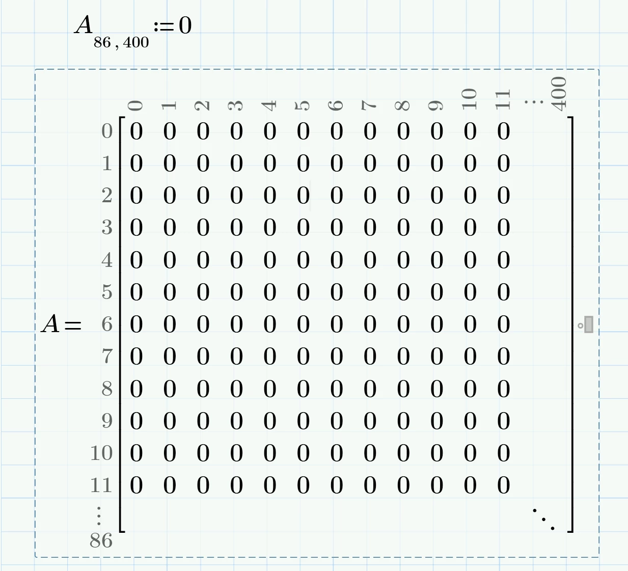

I'm not sure what I'm doing wrong but Mathcad is taking far longer than I would expect to create simple arrays.
Goal: create an array with 86,400 rows, all values are 0
For example, I can make an array like that immediately with B[86400 := 0.
However if i try to do the same thing using a while or for loop it takes nearly a minute.

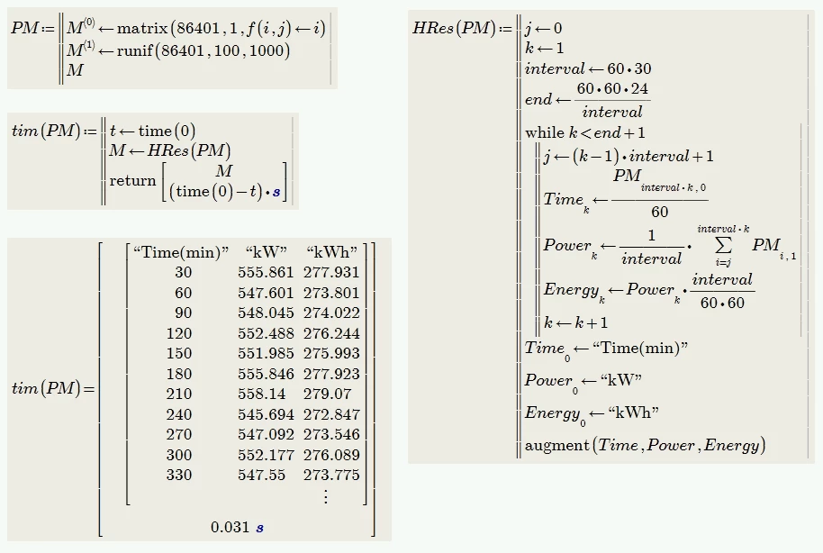

I guess your Powermatrix is a 86401 x 2 matrix. Thats not really big, indeed.
And you want to create a 49 x 3 matrix by averaging some values.
I retyped without doing any optimizations - just used a syntax to access matrix elements which I am more used to.
I even omitted the preallocation of the three vectors. Usually when dealing with big matrices thats a good idea but given that your three vectors are just 49 element vectors I guess the benefit will not be noticable.
As you can see in the screenshot it took about 30 ms to calculate your compressed matrix.
The calculation was done on a very old and lame notebook.
How long does it take youu to do the calculation? Or did I miss something?

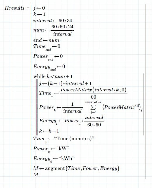

the sum of an interval of PowerMatrix is defined diferently in a reply compared to your jpeg.
[PowerMatrix(1)](i)i  in other words it must extract the column of PowerMatrix for each iteration in the sum.
PowerMatrix( i,1)  is direct access and faster in one of the replies.
It is also better to define the upper boundary of this sum as a number rather than calculate it each time for each item in the sum.

Thanks for the reply.  I'll be more specific with what I'm trying to accomplish.  I've essentially modelled power (kW) generated for every second of a day (86,400 seconds).  I have to calculate it at this scale.
I want to compress the data into 30 min intervals (1800 seconds).  1st column will be the time in min (30,60,90..) and 2nd column will be the average power generated within 30 min interval.  I've done this successfully, it just takes an excessive amount of time.
I read somewhere that it was faster to create a matrix with all 0's then with a loop replace the values rather than just create the matrix with loop.  It didn't affect calculation time that way.  Attached is the block that takes 15-20min to run.
