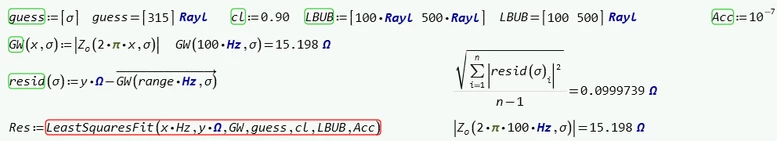

I' trying to work with LeastSquaresFit and functions and variables NOT unitless, and I'm having problems.

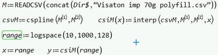

I have a variable ptc1681201_1-1766695724670.pngand some data obtained by interpolation
I want to find a value for ptc1681201_3-1766696045778.png such that the function ptc1681201_2-1766695984035.png fits the y values.
I have defined
Dimensionally everything seems correct:
But, when I try to use
I get: "These units are not compatible".
Which units? Everything now is unitless!

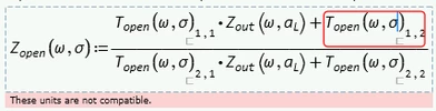

Dec 25, 2025 9:31 PM UTC
If you click on your LeastSquaresFit expression, go to the Calculations tab, and click on the Error Tracing arrows, where does the calculation trail lead back to?  Which expression does it point to?

Dec 25, 2025 11:42 PM UTC
From what you show it looks like it should work OK, so the error may be in the parts you don't show. That's the values in Matrix M and most importantly the definition of your function Z0. It may be that in some cases this function returns a dimensionless zero, while in other cases it returns a quantity with units. This can often work well, but in some cases it can lead to problems.
And then - error messages in Prime are not always accurate. The error does not necessarily have to do directly with the units.
I would therefore also recommend that you post your Prime sheet here. Either together with the data CSV file or with the data in a Matrix M that is already integrated in the Prime sheet (although this would be difficult to do in Prime).
Without the sheet, we can only grope in the dark and helplessly suggest one thing or another.
Apart from error tracing (which may refer to the Z0 function) as suggested by Stuart, you could also try omitting the optional arguments in the LeastSquareFit function (i.e., the last two) and see if the problem persists (I guess it will).
Or you could try your luck with the genfit function.
genfit(x,y, ß, GW)=   should also give you a suitable value for ß.

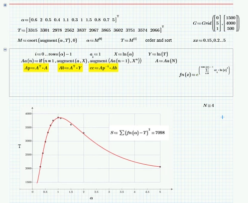

Dec 28, 2025 4:44 AM UTC
The attached program demonstrates a least squared fit of data to a polynomial function.  It works without the LeastSquaresFit function and runs in Prime Express, (built in version 4).
Since you haven't shared What your expression should look like you can try this on your data to get curves that fit polynomial functions of sigma.
Smarter people than I might be able to adapt this scheme to other function types.
Good luck.

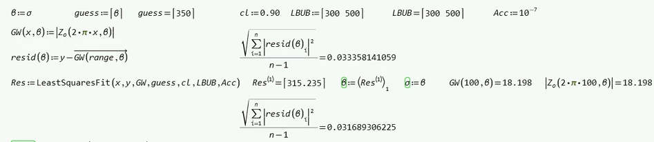

Dec 28, 2025 11:01 PM UTC
Hi, working with dimensionless variables in all the worksheet, since the beginning, everything works:
However
and
Those errors lead back to
However
So I don't understand why "Those units are not compatible".

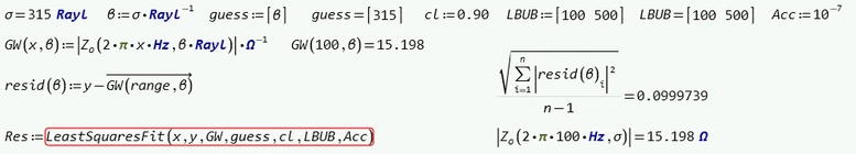

Dec 28, 2025 11:48 PM UTC
Please don't mind the slight numerical difference: I know where it comes from and it's unimportant!
