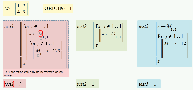

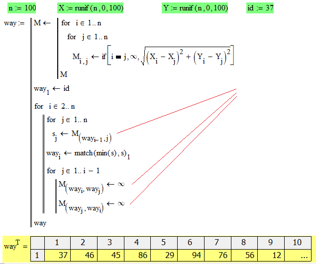

Here is the bug shown with a very simplified example. It has to do with the nested loops (which should have no effect whatsoever in this example). Omitting either loop will make it work.
7 replies
February 16, 2014
In my opinion it should work so I tend to call it a bug and you should report it to PTC.
I tried two easy workarounds which both work as expected:
  1. add the line "M <-- M" on top of your routine
  2. turn your routine into a function with at least M as parameter. I would add id as second parameter, n could be calculated from the matrix dimensions.
BTW, instead of the for loop (the first with variable j) you may consider using the new row select operator in combination with transposition.
Addendum: Its the for-loop which sets some matrix elements to infinity which throws the error. If you delete it (the routine won't give the expected results then, I know), M is accepted as matrix again. I am pretty sure that it is a bug!
February 16, 2014
Thanks, Werner - it is a bug!
February 16, 2014
Yes, I am quite sure about that now. I assume you will report it to PTC.
February 17, 2014
One more.
I can write in Mathcad M[(i ,j) but cannot in Prime.
February 17, 2014
I see, obviously lists are allowed in Prime only with prepended function name. But I am not sure if we should call this a bug.
What would the reason for using M[(i,j) be? You could write M[(i),(j) - this is allowed.
February 18, 2014
It is for better reading a sheet - see the picture.
But the Prime converter deletes those parentheses but does see the attch.
