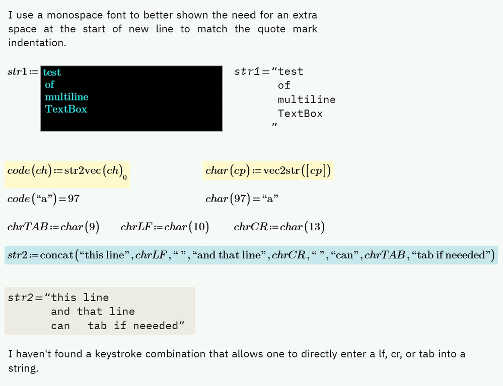

@TK421 wrote:
To get multiline text output from your JScript you can add a newline character "\n" to your string:
TextBox.Text("This is the first line. \n This is the second line.")
Just make sure that the Multiline box is checked on the Properties tab of your Text Box.
To break a string variable over multiple lines so it is more readable in your script you would type:
myString = "This is multiple lines in your code,";
myString += " but will be returned to the TextBox as one line";
Yes, I already do that, thanks.  However, LF didn't consistently appear in a string returned from a control.
Interestingly, LF, CR, and TAB work as you might expect hope when viewing Mathcad strings.
