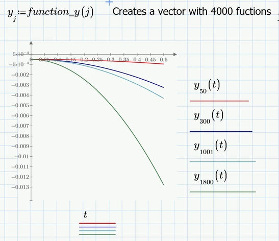

I would appreciate your help in fixing the solution to a second order differential equation.
I am attaching the spreadsheet I created in Mathcad 10.
Thanks in advance for a timely feedback!
Best regards, Peter
Werner_EAnswer
The correct syntax is y:=odesolve... and not y(t):=...
But the main problem is the fact, that M and F0 are vectors and not scalars!
For every line in the vectors M and F0 you would get a different function x!!
Here as an example I have chosen index 1001
You may also parametrize the solve block with the vector index.
Now you could show a few of the 4000 different functions in one plot
Prime 10 worksheet attached

Werner_E25-Diamond IAnswer

23-Emerald V
The simpler approach is the fact that the solution for the ODE:
is:
And with: x(0)=0 and x'(0)=0 the two constant C0 and C1 are each zero, so:
And with this you can plot x(t) for any values of F and M.
Hello Luc, thanks for the valuable feedback! Best wishes, Peter
