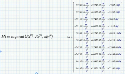

I have some questions about the attached file (questions are highlighted yellow on page 3 & 4). I'm trying to extract columns from my matrices Pz, Px, and My and combine them into new matrices, each with a Pz, Px, and My column, plus zero values for Py, Mx, and Mz.
My first question: why do I lose my units when I convert the nested matrices Pz, Px, and My to regular matrices with the method I used?
Second question - in order from easy to difficult: How do I create one matrix taking the first column from Pz, Px, and My? How to create three matrices with all columns extracted one by one? How to keep the number of matrices flexible in case columns in Px, Pz, and My are removed or added? I'd really like to understand how to do this for future projects as well.

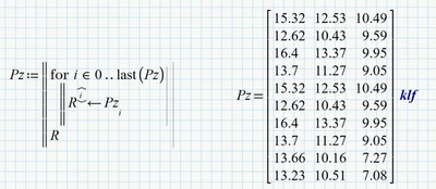

Your function Pz (as well as the others you defined) should not have the sane name as the variable you would like to use as its argument.
Furthermore is your function not using the argument M for its calculation but it uses the worksheet variable Pz and immediately overwrites the argument M with its calculations.
So if you really want to use a function, you should do it that way (I am using the name "R" for the local variable because I am thinking on "Return value" or "Result"):
But if your goal simply is to unravel the nested vector Pz, the most straightforward way would be
You can also avoid the nested structure right away by using the "stack" command

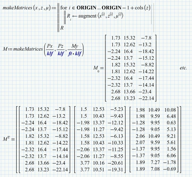

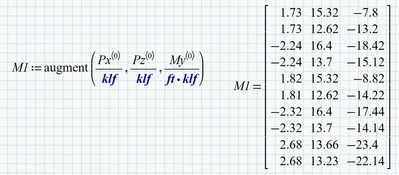

Unfortunately you can't change the units when displaying a matrix with mixed units.
If your intention is the export to Excel, you would make it unitless anyway:
Maybe that way:

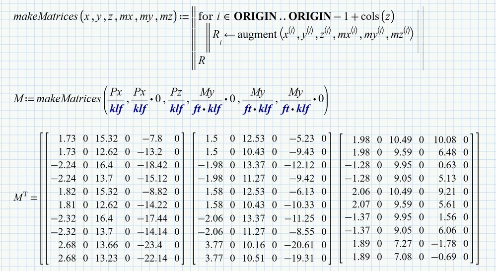

According the zero values for Py, Mx and Mz you could use

Oct 25, 2023 4:41 PM UTC
Unfortunately provides PTC no way to save or convert a sheet to the format of a lower version.
But actually you see in the pics all you need to retype the few lines.
Furthermore, which is not shown in the pics, I unraveled the three nested matrices Px, Pz and My as I had shown with Pz in a prior reply like this
I used this method because it was easier to do compared to using the stack command right away 😉

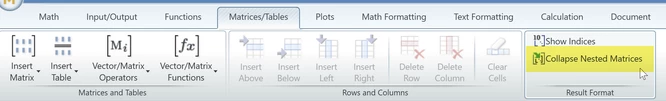

To actually see all three matrices when the nested matrix M^T is displayed, you have to turn off the option to collapse nested matrices

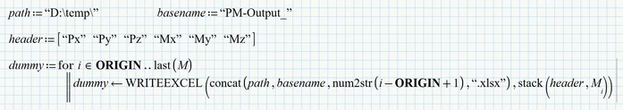

To create a separate Excel file for every matrix in M, you could use something like
The assignment to dummy variables is necessary to "trigger" the write command(s).
The Excel files are numbered starting with #1 (independent from the setting of ORIGIN) and look like this
