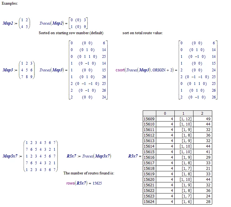

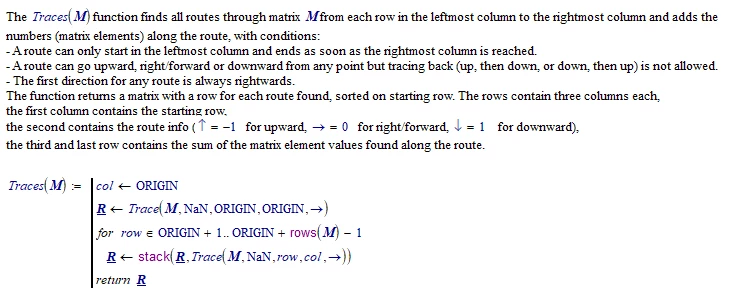

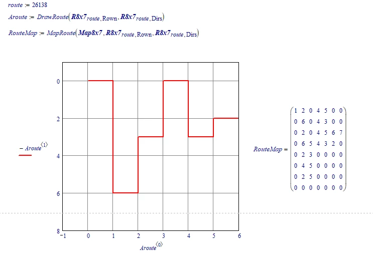

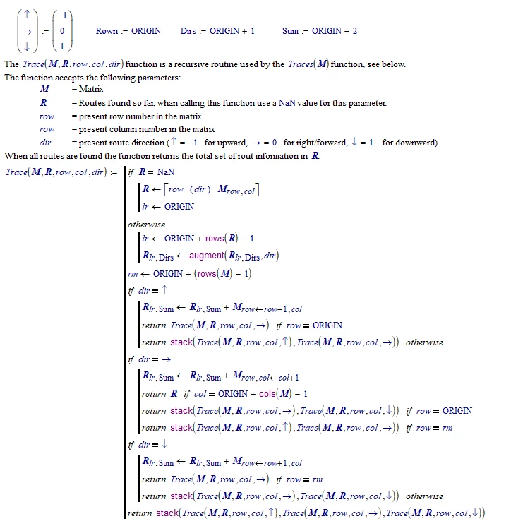

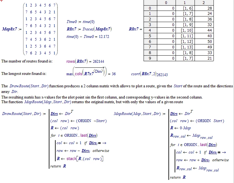

23-Emerald V
August 9, 2017
It appears to me you want to have the path for each route as well.
I made one simplification: starting in the first column, a route can only go left as the first step.
Here is the implementation and some results.
Of course, with the amount of informatioin stored, the maximum array size determines the maximum size of the original matrix that can be processed successfully.
It appears that in Mathcad 11 8x7 is the largest size.
Maybe Prime allows to go further, but (as Werner already observed) there's also a (calculation) time aspect. Time grows exponentially with matrix size.
