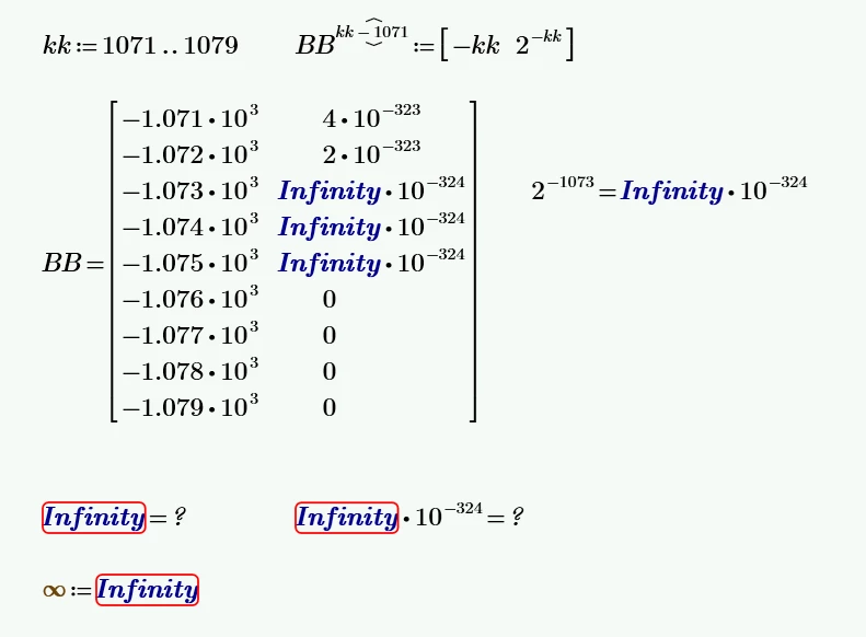

MEP - Change Mathcad numerical infinity to IEEE 754 Infinity
Mathcad Enhancement Proposal:  Change Mathcad's numerical representation of infinity to the IEEE 754 floating-point standard.
When dealing with large numbers, representing infinity as 10^307 can lead to numerical errors and yield ambiguous or unreadable results.
Note: Python math, NumPy, Mathematica and Matlab all give correct results.
I don't know why 2^1020 is allowable, but 2^n, where n:=1020, raises an error.
Stuart
(Numerical ∞ = 10307 has annoyed me since Mathsoft Mathcad days.  At least change βˆž to ⧜ (U+29DC Incomplete Infinity)

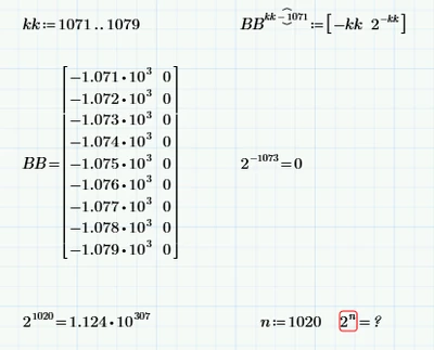

23-Emerald V
Nov 16, 2025 3:44 AM UTC
Interesting.
Math Result display set to "General".
Stuart
23-Emerald V
Nov 16, 2025 12:10 PM UTC
The 'Infinity' unit was introduced in Prime 6. Up to and including Prime 5 you'd get:
But the funny behaviour with 2^1020 was already present in Prime 2.

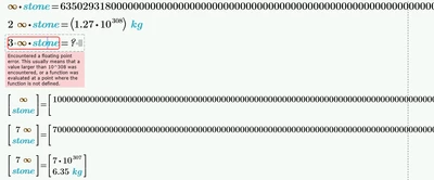

23-Emerald V
Nov 27, 2025 1:43 AM UTC
By the Power of Grayvector and by the Magic of Mathcad’s Unit System, Werner’s work in another thread has inspired a technique for saving us from Thanos by transmogrifying an infinity stone into a very large number of kilograms,
I knew I'd find a use for a finite infinity.  Previously, I could only destroy them two at a time before the structure of the 64-bit floating-point universe threw an overflow error (which wouldn't happen with a proper IEEE 754 infinity).   But now I can handle all of them at once.
I’m not sure it’s a good enough reason to retain 10^307 as infinity, though.

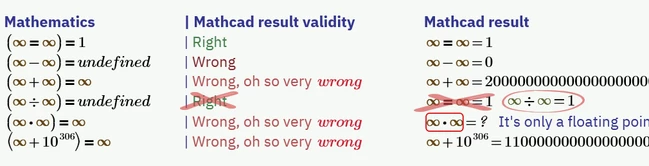

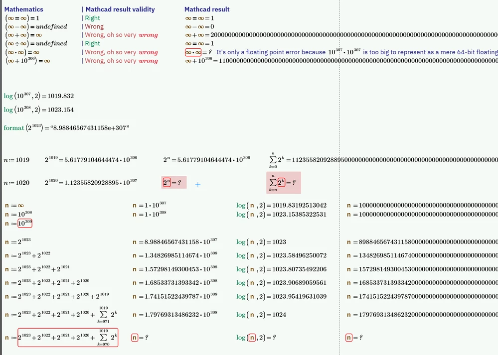

Nov 27, 2025 6:16 AM UTC
Unfortunately only one "Right' out of six:
BTW, you get correct results with the full version and using the symbolics:
in Prime as well as in MC15
23-Emerald V
Nov 27, 2025 5:10 PM UTC
Thanks, Werner.  Looks like a copy & paste error on my part (I forgot to change the equality operator to division).
Compatibility with symbolic results (where meaningful) is another good reason to implement a proper IEEE 754 infinity rather than an arbitrarily large number, say, π’Œ‹π’— π’Ž™π’– π’‘ͺ π’‘ͺπ’˜ π’‘ͺ𒐝 𒐝 π’Ž™π’ π’‘ͺπ’œ π’Ž™π’š 𒑩𒐗 π’Œ‹π’› π’Œπ’• π’‘ͺ𒐕 π’š π’‘©.
(And if you're going to pick a big FP number, why 10307 rather than 253-1?)
