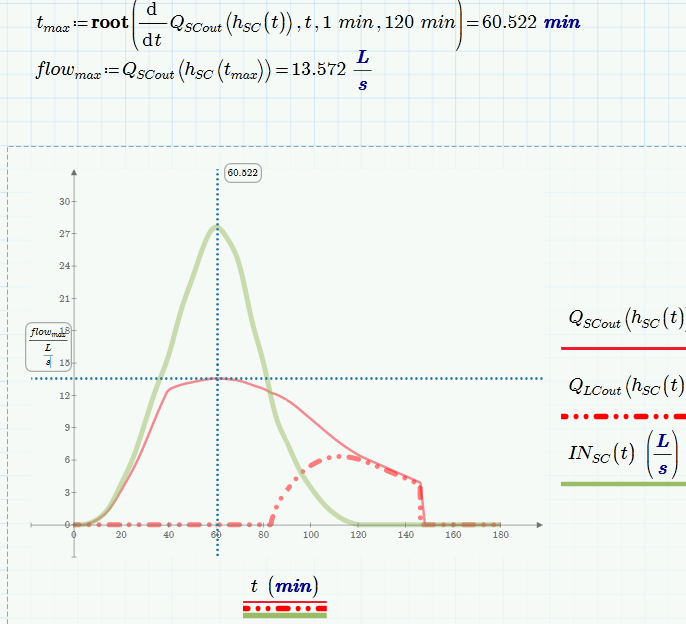

The last and final problem is a way to auto place a horizontal marker to show the peak discharge. As you can see from the final graph I am doing the placement manually because for some reason if I use Qscout(hsc(t) in the place holder I get an error.
Huh!?? What value of t you would have provided when you tried this?? Its silly, but those markers are not allowed to contain any units. So you may place QSCout(58min)/(L/s)in that marker placeholder. But first you would have to solve for the max time. One way is a differential appraoch like the following
