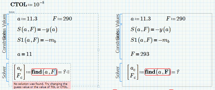

I have a problem solving an ODE. I want to calculate the deflection of a beam, but at the beginning I don't know the force and the force application Point. So I make a guess of it. With a good guess or with iterations (very much work) I can solve it. But because I have many situations like this, I want to do it automatically.
In the attached file I have simplified the problem  and explained it more detailly.

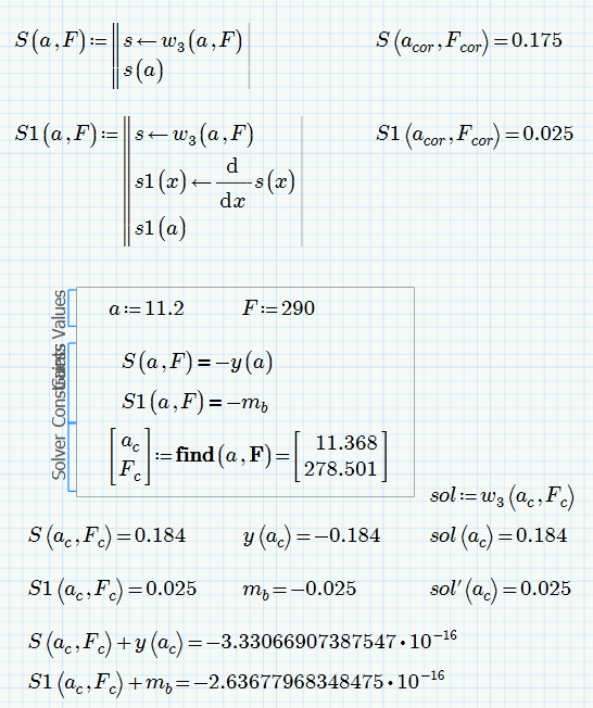

One way of doing it would be like the following:

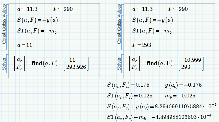

You may want to compare accuracy against the values you had found:
At first sight it looks like you can find an a-value for any given F.2-value within a given range and vice versa (I have chosen the values you found in the following examples)
but as soon as you lower the value of CTOL, no solutions are found
Regards, Werner
PS: Instead of "find" you could use "minerr" (especially when you think that there is no perfect exact solution and so it will find a solution with lower values of CTOL, too) but your choice of using "minimize" was wrong.

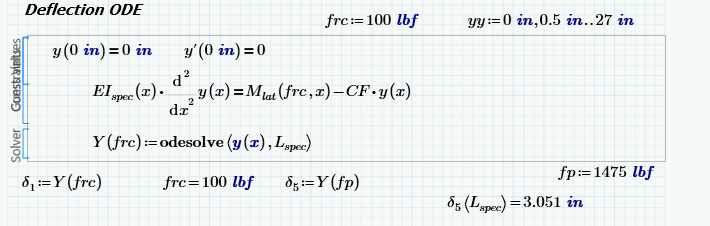

You're using 3.1, so I can't open your sheet (stuck in 3.0.)
I solve beam deflection by solving the differential equation [EI d^2y/dx^2 = M(x)].  You can develop the equation for moment along the beam for whatever force arrangement you have.  Two additional constraints are required--if it's a cantilever these would be displacement and slope at the origin.

You can make I a function of x as well as moment. If I(x) requires integrals it will slow down computation; one way to speed that is to create a vector of I at points along the length and fit a polynomial (function "regress") to the curve.
I have problems with tension and compression along with lateral loading, so I need terms of M(x) + Faxial y(x) was well as variable I(x).  They all can solve.
