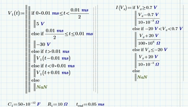

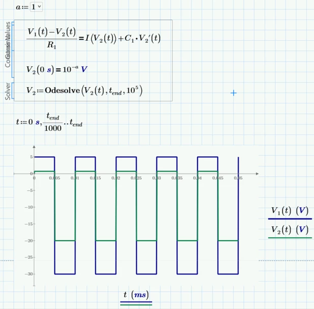

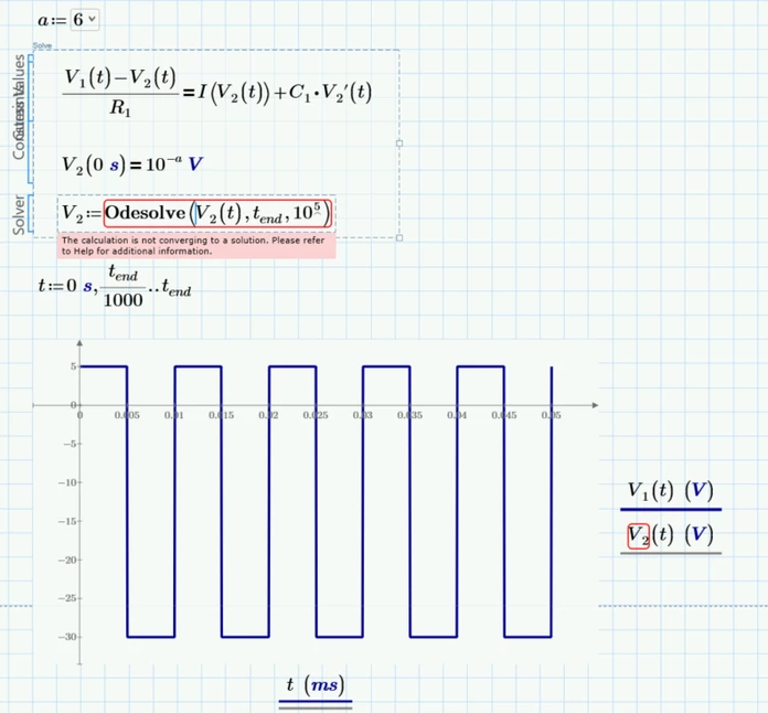

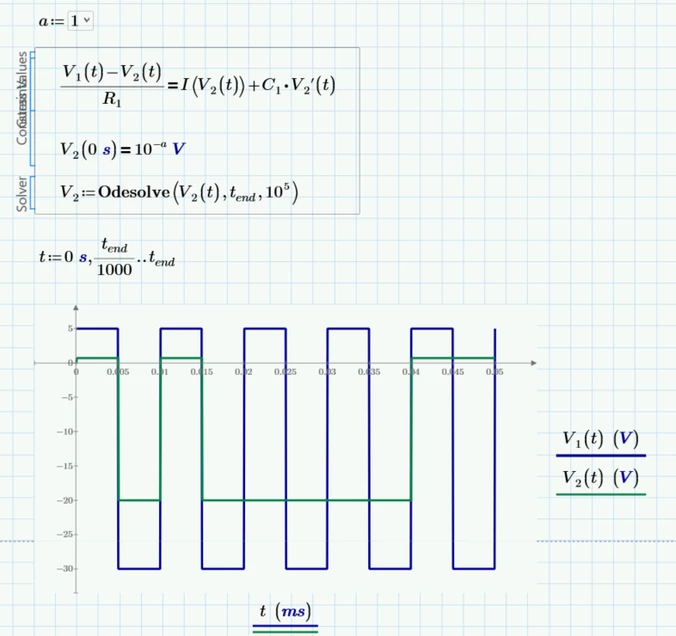

Odesolve bug? Another bug?

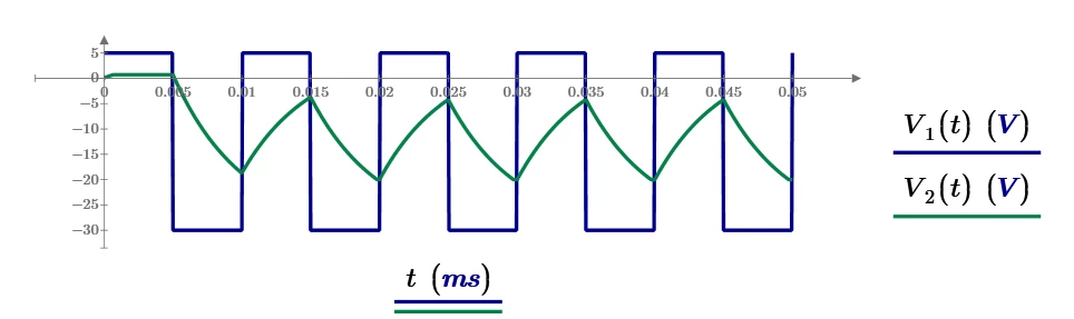

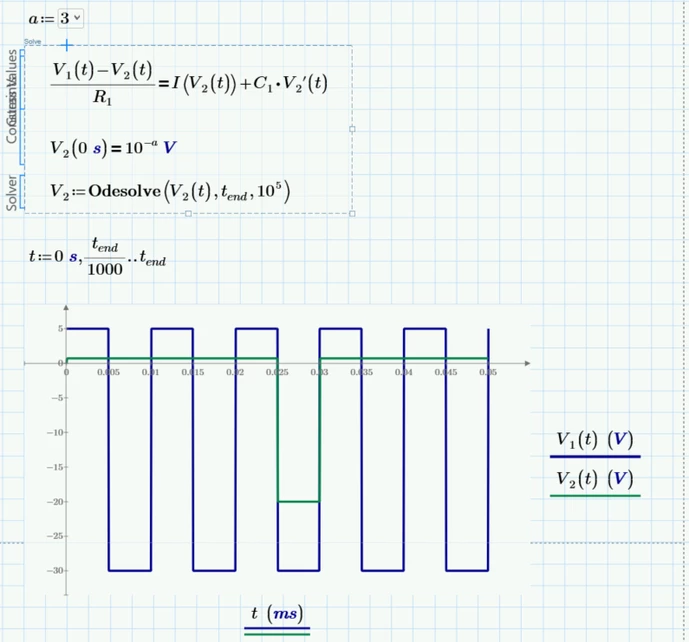

Change variable a from below and look at the V2(t)...Why odesolve block is behaving like this? Is it normal?
Prime 10 file attached.

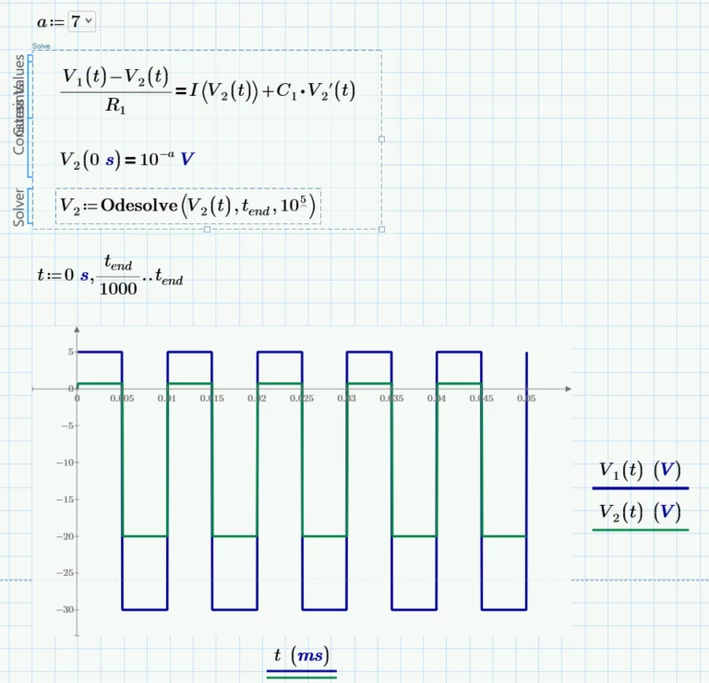

The expected behaviour is like a =7.
32 replies

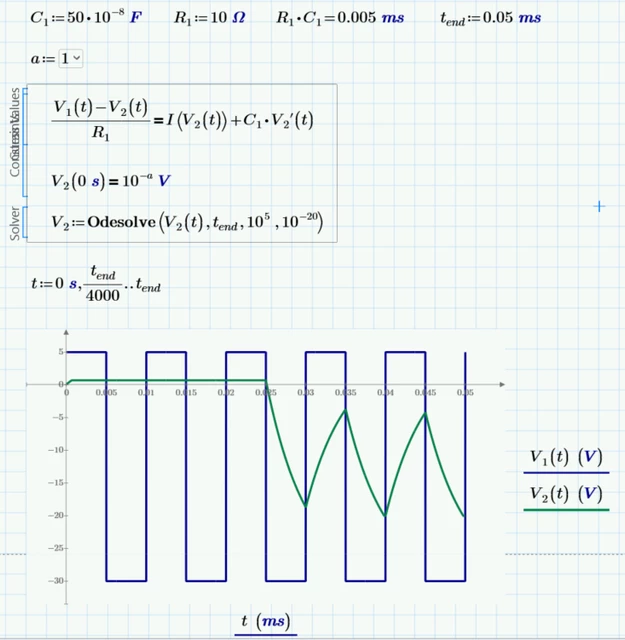

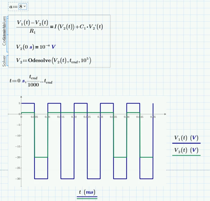

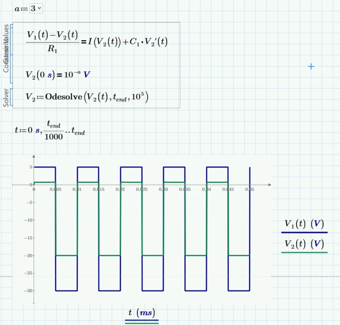

The above results are for this:
IF I change to Fixed:
If I change to Adaptive:
Endless running:

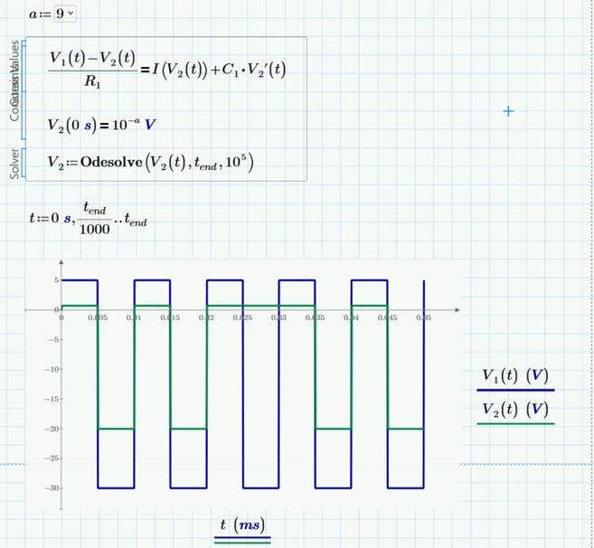

And If I change to Radau:
From a=4 until a=8 its ok, but when a=9 not:
a = 10, 11 - ok

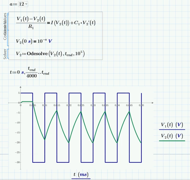

a = 12 - NOT ok...
It seems that Radau doesn't make so many misses (at least in this example), and at least as not many as Adams/BDF does.
Its a bug? Or what's happening?
Jun 17, 2024 12:03 PM UTC
The solution to this relatively simple initial value problem fails due to the discontinuity of the inhomogeneity. This means that "theoretically" there is no statement about the existence and uniqueness of the solution. Perhaps reformulating it as an integral equation will help. Numerically, less sensitivity can then be expected. Or the inhomogeneity can be approximated by a continuous function. However, MC would probably be unable to cope with this.

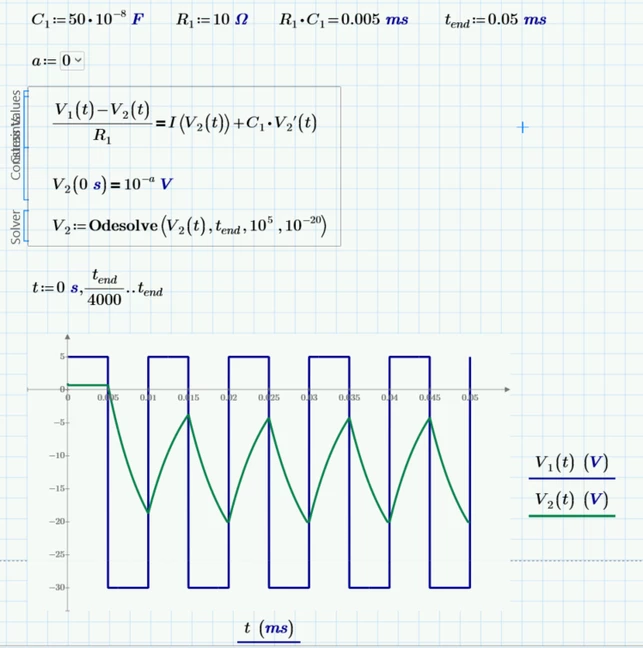

But anyway, the problem is still present even so:
Below is with Adams/BDF:
And with Radau:
For all a:0...12 the same results are maintained in this example with Radau:
But as I said previously, we should not changed the values of components. We should have the initial values:

Jun 19, 2024 8:06 AM UTC
It's not an Odesolve BUG, it's just complications of numerically computing the voltages and currents, given the non-linear /discontinuous behaviour of the derivative of the diode function I(Vx).
There are other tools better equipped/specifically geared for this kind of calculations, e.g. LTspice:
(a simple diode model with a breakdown voltage of 20 V) gives:
And with the diode modelled per the I(Vx) function:
we get virtually the same result:
There are minute differences. The top line of V2 here sits at 0.7 V, while with the previous circuit it is at 0.8 V.
Note that the capacitor value is so small, it could just as well be left out. That would render a non-differential equation to be solved.
If the capacitor is increased significantly (as TTokoro did) you'd see some effect of it:
