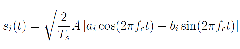

I'm having trouble reconstructing an OFDM QAM signal using its amplitude and phase spectra obtained by using the DFT. The QAM signal is given in the image below.

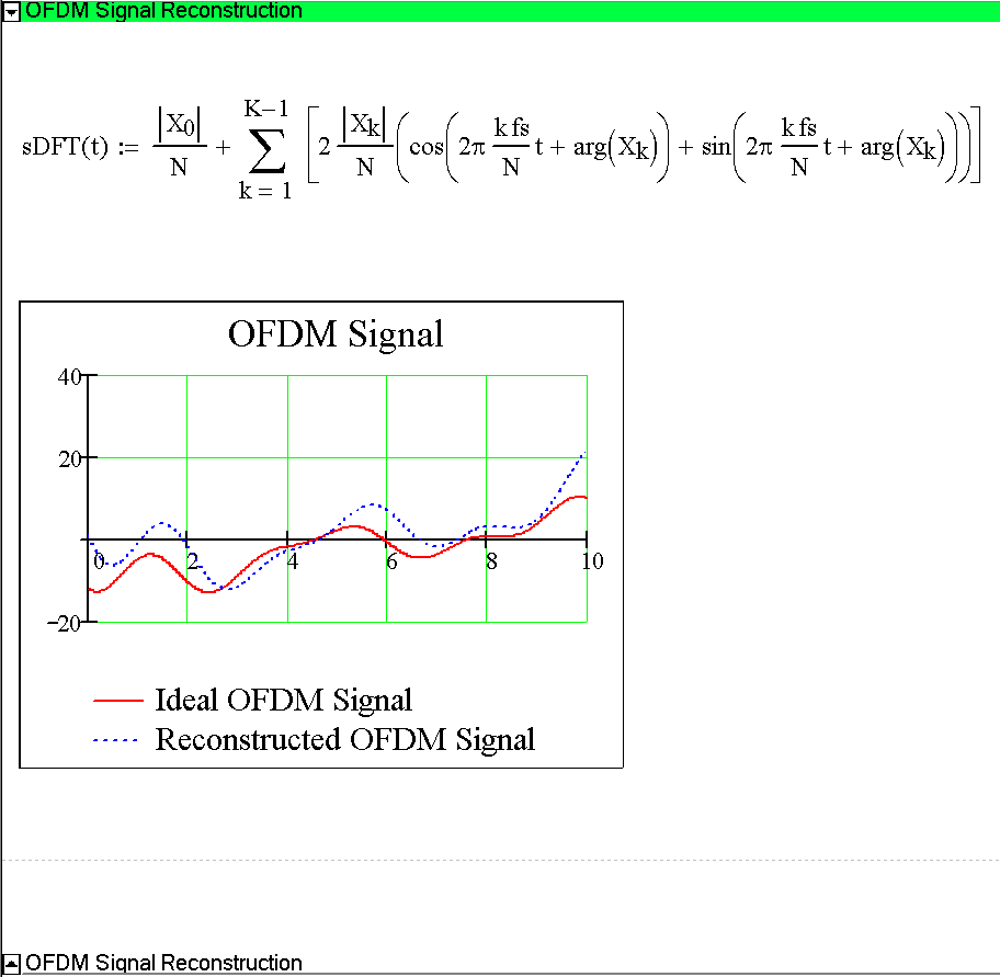

I have tried to do it so far using the below equation.
This is the closest I have reconstructed it to the original. What am I missing?
I am using Mathcad 13.
