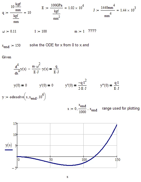

Mathcad can't solve ODEs symbolically (at least not out-of-the-box), but it can provide a numerical solution, given that you provide the values of all the constants involved (this includes the value of m which is not specified in your text).
Mathcad provides a couple of stand-alone solvers for ODEs and also a convenient way using a solve block with "odesolve":
Guess it didn't made much sense that I had chosen x.end larger than  l=100  😉
Mathcad 15 sheet attached

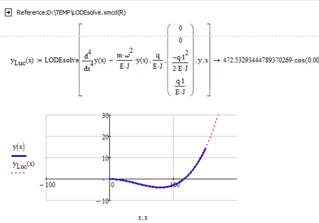

One additional comment because I had written that Mathcad can't solve ODE's symbolically out-of-the-box.
@LucMeekes  has provided a toolbox for Mathcad to solve ODE's symbolically ->  Toolbox: Solving Ordinary Differential Equations
When I use it (with the constants still assigned their numeric values) I get a solution consistent with the one derived by Mathcads solve block.

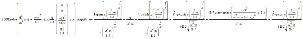

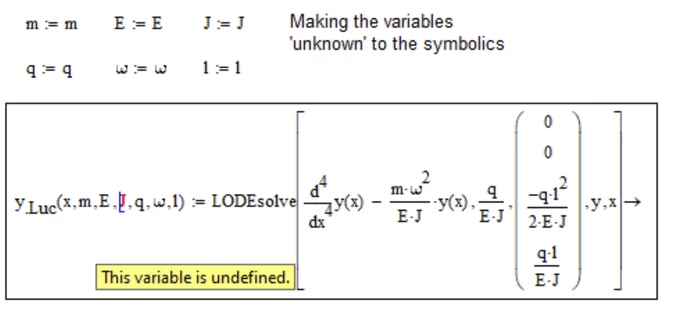

But trying to get a pure symbolic result failed:
I guess the reason is the "invlaplace" function in the symbolic result

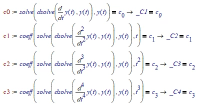

And the enhanced Maple-engine in Mathcad 11 is powerful enough to solve the ODE:
with:
we can solve:
which gives:
now to solve c0 through c3:
The result of which we can feed back into ys():
Gives:
