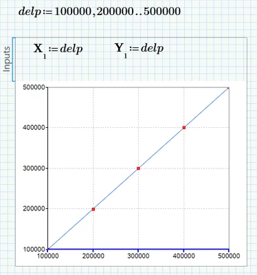

I am trying to get a very simple plot, of the bisector in the first quadrant. For my application I am interested to have a graph for the range of relatively high values of abscissa, e.g. from 100000 up to 500000, like in the top left figure in the attached file (Mathcad Prime 8).
I’ve tried both “Plot” and “Chart Component”.
I am curious about what I have done wrong in my humble tries.
Thinking that such graphs can be carried out so smoothly in Mcd 15 in one minute…, thank you for any suggestion, best regards,
Liv.
Werner_EAnswer
The Chart Component does not offer a "quickplot" feature (plotting a function without defining the abscissa values). Thats why your first Chart attempts failed. As Luc showed you have to define the abscissa values first.
As for the native plots, Prime does not allow to plot one range over another range
Interestingly it allows to plot a range over itself
Prime allows a range at the abscissa and a function dependent on that range at the ordinate:

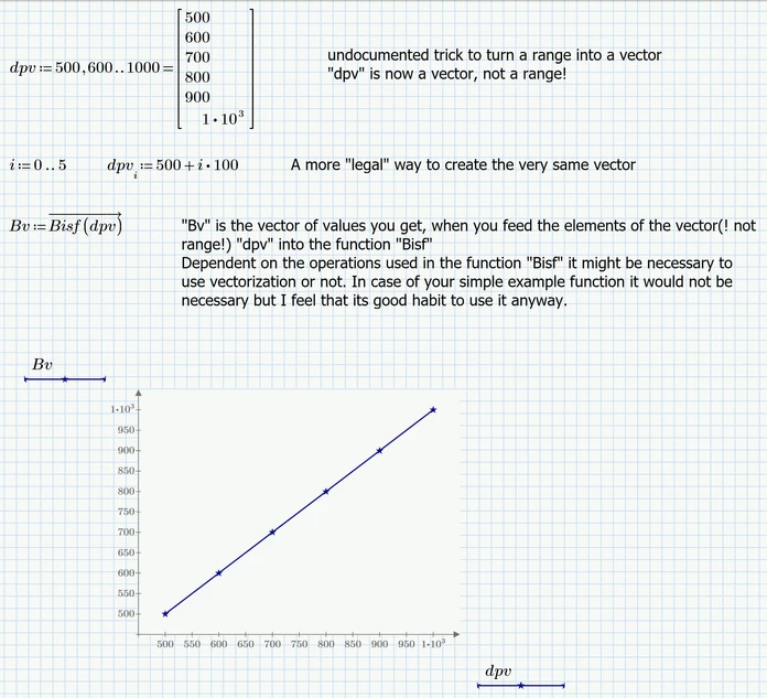

OR you can use vectors (not ranges) at both the abscissa and the ordinate:
BTW, while Mathcad 15 would allow to plot one range over another, you don't get what you expect, either. What you get it kind of a waterfall plot:

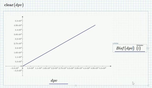

Just add this:
before the first graph to get this:
Or did you mean something else...?

Werner_E25-Diamond IAnswer

Agree with you, it's healthier to use vectorize.
Yes,  in MCd15 I used for vectors representation Xi and Yi on axes, where index i was indeed previously defined.
Argument "dpv" will be that defined array for the rest of the worksheet.
For a subsequent symbolic calculation one needs to use another variable as argument. Am I right ?

You can still use the quickplot feature for the native Prime plots the same way as in Mathcad 15. You simply have to use an undefined variable name at the abscissa. On contrary to Mathcad 15 we have a way in Prime to make a variable completely undefined again, the "clear" command.
Similar to Mathcad 15 the range you see in the plot is controlled by the values you set in the plot. In Prime you can edit the first, second and last value at each axis, so you can set start and and end value and step width that way.
As for subsequent symbolic evaluations you may either use the quickplot feature as just shown or, if you have already defined the abscissa values as a vector or range, you can either use a new undefined variable or make the already defined variable undefined again using the "clear" command.
You can also use the clear.sym(variablename) command to make the variable unknown/undefined for symbolic evaluations only. This is similar to using an assignment like variablename:=variablename in Mathcad 15.
