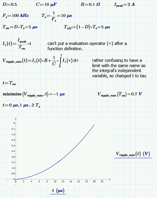

October 20, 2015
SAMEER GARG wrote:
Please find final outcome as per your suggestion

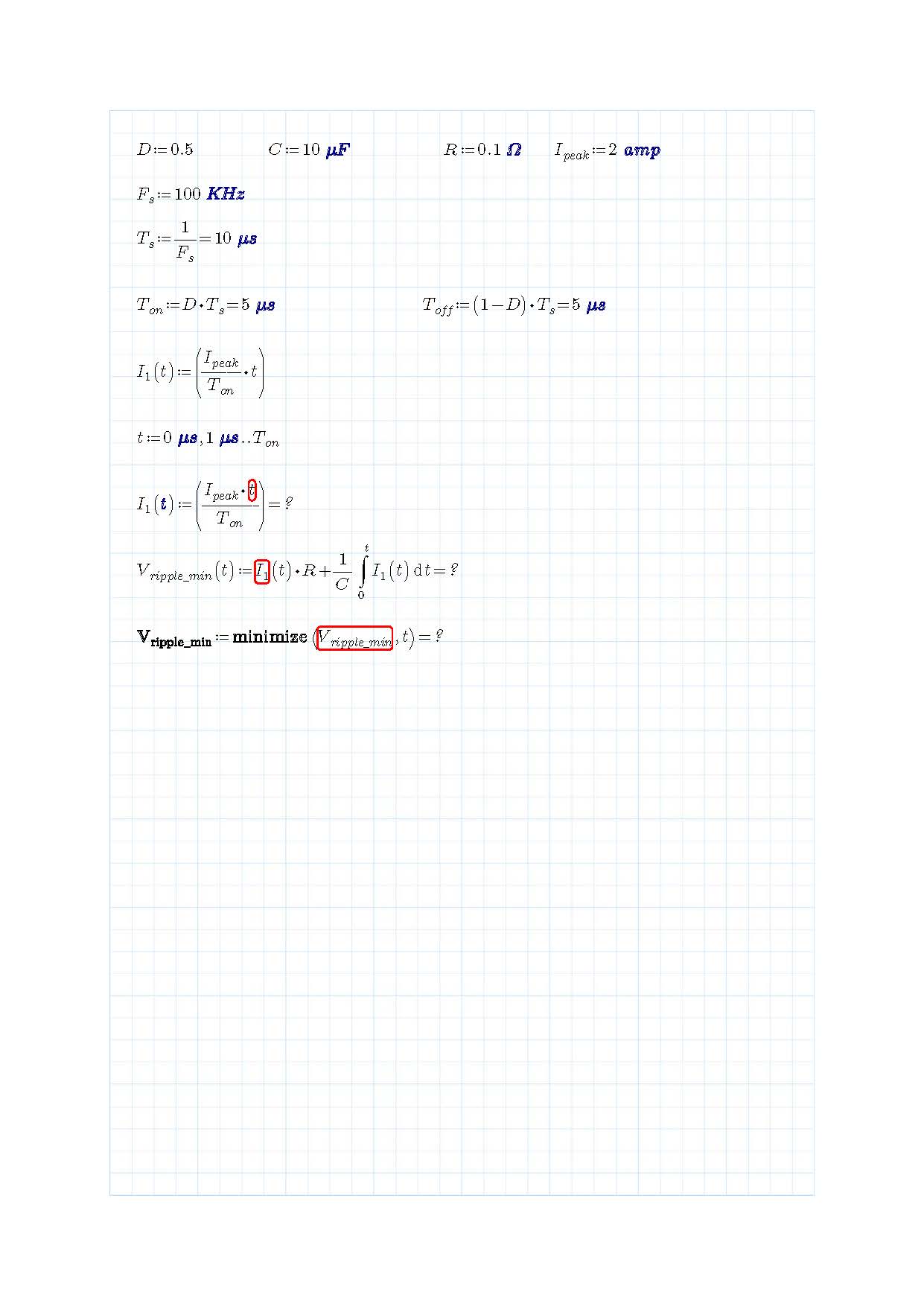

Are you sure about your equations?  I'm not sure they will give you the minimized value you are possibly seeking.
A few comments.
You have defined I1 and Vripple_min to be functions; this means you cannot put an evaluation operator (=) after them - this is in part what Mathcad is complaining about.
It's usually well worth while evaluating functions at a few values (especially critical ones) and/or plotting your functions to check if they make sense over the intervals of interest.
I'm surprised Mathcad let you type in KHz instead of kHz; the SI multiplier for 1000 (kilo) always has abbreviation 'k' not 'K'.  Indeed, 'K' is often used in computing circles to mean 2^10 = 1024 (eg, KB).
It helps others if you post your worksheet - saves all that typing and there are sometimes problems with a worksheet that aren't obvious or visible from a screenshot.
Stuart

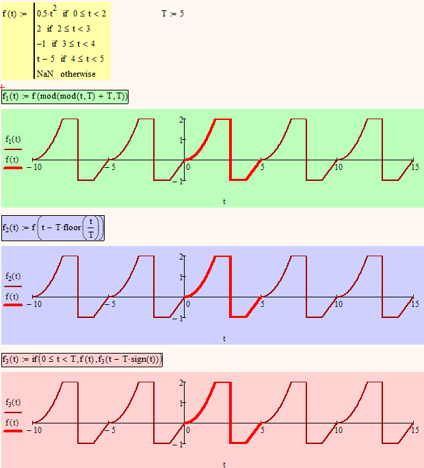

Unfortunately using mod() to make the function periodic will fail for negative arguments. This is because the mod() function is implemented in such a way that it will return negative values for negative arguments -> mod(-12,5)=-2 (and not 3).
You can cope with that problem by either overwrite the built-in mod() function with one of your own or by applying mod() twice (after adding the period T after the first mod().
Here is a different way to define a piecewise function using the programming if statement instead of the if function. If you are using Prime Express or intend to create worksheets for Express, you have to use nested if-functions as programming is a premium feature not available in Express.
Furthermore I show three different ways to make a function periodic. The last one, using recursion, is in no way recommended and is only there as for academic interest.

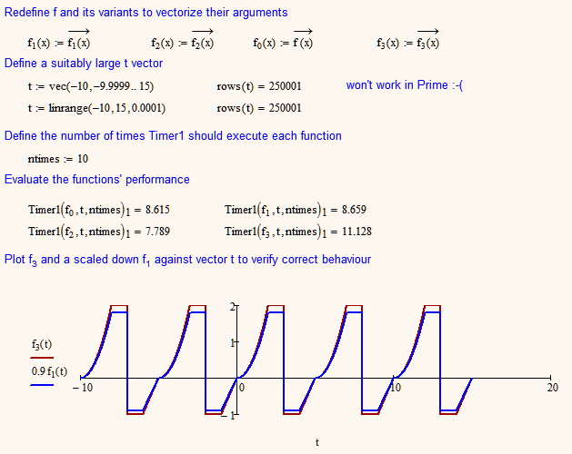

I am surprised that the non-periodic f_0 is performing that bad when you did the timing. I tried, too, and f_0 would outperform all the others.
I also introduce a new fourth variation which simulates what the recursive variant does using a while-loop but the gain in speed was by no means noteworthy. I would have thought that getting rid of multiple function calls, bulding up recursion stack would have a bigger effect.

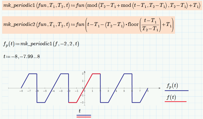

The question seems to come up quite often.
I just found a Prime 3 sheet which I posted some time ago as an answer to someones question.
There I turned the first two methods to make a function periodic into convenient functions. Maybe its of help to you, too. The meaning of the arguments should be obvious.

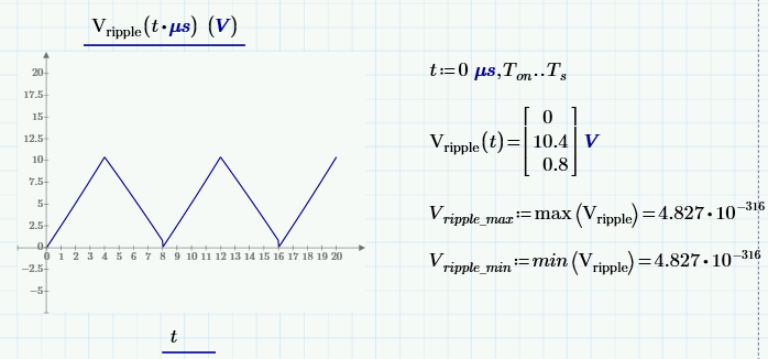

Thanks for your kind response. I would like to calculate max and minima of  any function. I was going through Max and min function but i was getting some unpredictable answer. Please help in this regard.
Note: It is a part of system so all variables are defined previously.
23-Emerald I
October 19, 2015
Try
"max(Vripple(t))"

I'm not sure that will give the desired result - t is a range variable, so max should return the "maximum" (ie, the only) for each value of t.

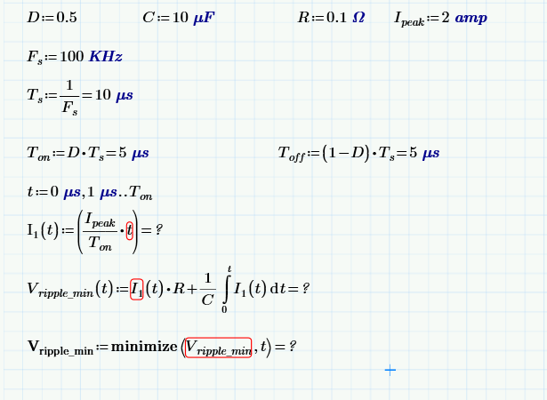

Thanks for your kind interest. But sorry to say I am not getting any solution yet. Please find attached DOC for the reference.I actually want to find critical point of any function. Maximize/Minimize are suppose to put on Vector but I am not getting what makes not to it to do so.Problem.jpg
23-Emerald I
October 20, 2015
It looks like the t in the argument for I(t) is considered to be a unit.  (Prime makes units bold and dark blue.)  In the math tab on the ribbon, pull down "labels" and make that "t" a variable.  That should get rid of the red box in that equation and in the definition of V ripple.  Then all you have to worry about is the correct set up for minimize.  (I think it takes a guess and/or a range.)

October 20, 2015
Hello Fred Kohlhepp
I did the same but it not works out.
