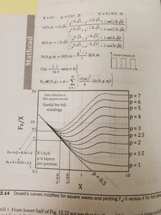

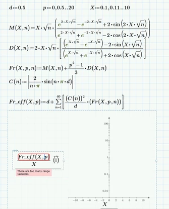

The image below on the left is what I am trying to accomplish and what I've typed out within Mathcad.
The image below on the right is the book example I am trying to replicate.
I am trying to plot Fr_eff/X vs X with different "p" values, which makes sense when looking at the text.

  1. Why is the error "trying to plot to many range variables showing up?"
  2. In the example textbook they are showing the function they are Plotting "Fr/X". How are they plotting the function without writing the inputs to the function, ie. Fr(X,p)?
  3. They are only plotting p=0.5 up to 7 (in increments of approximately 1 in certain cases), which is not how they define p at the top. How are they only plotting certain p values, and not all of them?
  4. Last and obvious question, what am I doing wrong?

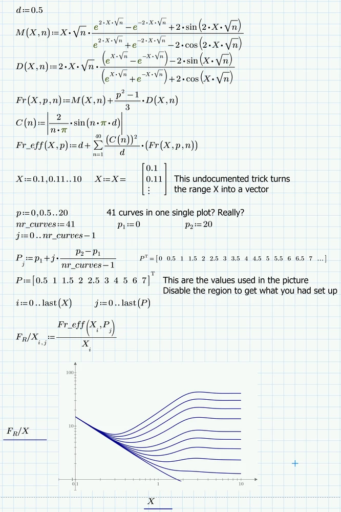

Here's the "magic" 😉
You type square brackets in defining some of the functions. Never do this unless you intend to create a vector/matrix. Only use parentheses . Mathcad 15 and below sometimes used square brackets on expressions with nested parentheses when displaying them, but you never type them in.
The picture shows that the horizontal x-xis also should be logarithmically scaled. You can move the axis with the mouse so they cross at (1; 0.1).
The upper limit 50 on the vertical axis is ignored by Prime - it always choses powers of ten.
Unlike real Mathcad Prime does not offer an option for adding grid lines. Luc an me both had posted workarounds for this. PTC bought a third party tool and integrated it (quite badly and with severe limitations) in Prime. They call it the Chart Component. You may create your plot using it. Its slow and cumbersome to use and does not support units, but it provides many of the very basic things which Primes native plots are missing, like grids, seocondary y-axis, labels, etc. Give it a try and see if it fits your needs.

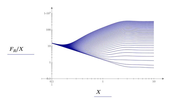

BTW, here is the plot using the 41 p-values you had set up. I also let Prime chose upper and lower limit of the y-axis automatically, so it now runs from 0.1 to 1000
The variable name FR/X is quite tricky to create. Of course you can use any name you like.

Plotting a family of functions in one go using two range variables is something which worked (with limitations) in real Mathcad,
but it doesn't work anymore in Prime.
There may be workarounds (apart from plotting ten separate curves), maybe using the waterfall trace, but I won't retype from the pic what you already typed 😉
Sheet in format Prime 9 attached
