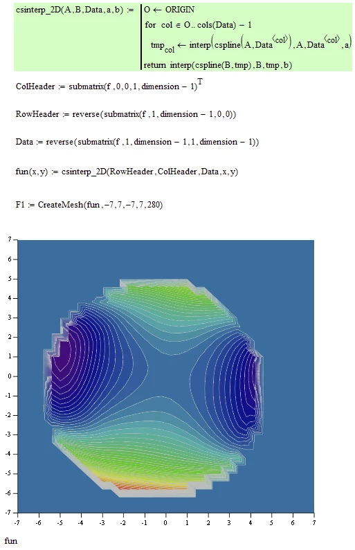

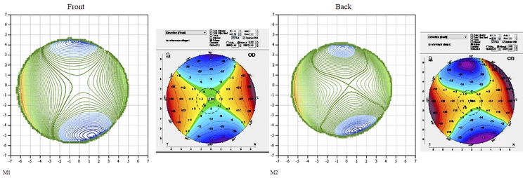

The data for cornea topography is loaded in the worksheet attached. The contour plot is generated using the 2-D interpolation algorithm. However, when compared to the topography system's original performance, the plot has a very low resolution. How can I get a plot that looks like the system output?
I was also curious about how the data could be transferred and plotted in polar coordinates because I was having trouble mapping f(x,y) to f(r, theta) coordinates.

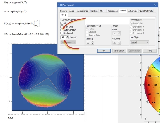

I used a routine I wrote a while ago to accomplish the interpolation and got a result similar to yours (not sure why it looks so ugly at the circular border). My routine is much slower than the built-in one but has the advantage of not being limited to square data matrices. Its not necessary to use it in your case and I just gave it a try to compare to your approach.
BTW, here is a way to add a rudimentary color legend:
MC15 sheet attached

You may try to uncheck "Auto Contour" and set a higher number of contourlines manually.
I also draw the contour lines in a single solid color, not Colormap.
To duplicate the colors in the picture you provided, I guess you will have to create a custom color map.
BTW, the data you embedded in the MC sheet seems not to be the very same which was used in the picture you provided.

I have now loaded the whole data in the worksheet containing the front and back surface data. The interpolation argument has been changed to (y,x) instead of (x,y) and I think the orientation is now right. The issue is that the unit plot is within an 8-mm circle, while the worksheet plot is within a 6-mm radius circle. Is there any detail that has been lost?
I should point out that I intend to use the topography data for optical raytracing through the eye (i.e., finding the normal vector and ray intersection), so graph quality isn't a priority.
Thank you once again for your assistance.
Payman.

I am not sure if I understand the issue. As written above it looks to me that the plots in the pictures you try to duplicate are based on different data values than the ones in your Mathcad sheet.
After all the row and column headers in the data in your sheet are running from -7 to 7 only (with mostly zero values at the ends) while the pictures show values up to about 8.5 (I see no negative values in the pics?)
Furthermore the plots in the Mathcad sheet are not symmetric on contrary to the plots seen in the pictures. You may turn on gridlines to better see that:
