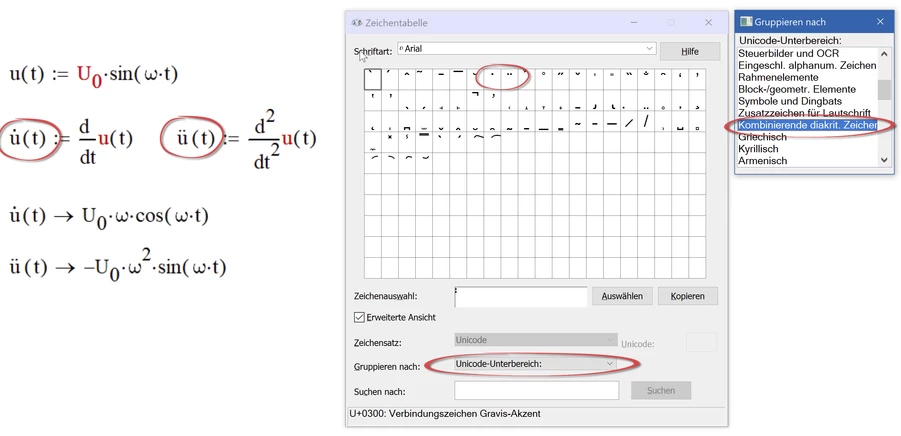

Or are you talking about Newton's dots-notation of a derivative?
Here you would have to use Windows's character map, group after Unicode and chose the section with diacritic characters.
Use U+0307 and U+0308 for one and two dots. Not sure  how to create higher derivatives (e.g. three dots in triangle shape on top of a variable name).

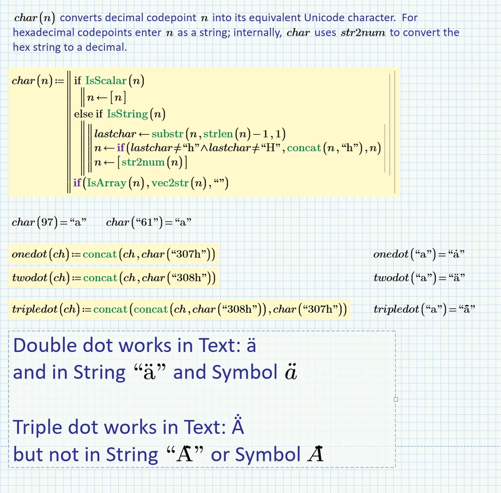

Following on from Werner's comments, here's something (modified) from a Unicode worksheet that I wrote a few years ago.  It's in Mathcad Prime 10, but I think it should port to Mathcad 15.
For those not familiar with diacritical characters, they effectively give an application's screen drawing code instructions to "backspace" over the preceding character and overstrike that character with the diacritical character.  Consequently, to delete the overstruck character entirely both the character and the diacritic must be deleted.
In some rendition systems, diacritics can be combined; in the triple dot case shown above, this means deleting three characters to delete the overstruck character.  Diacritics can also be confusing when moving the cursor across a character - usually, two movements are required.
NB: In Prime, To make use of a single- or double-dotted character, copy the string output, paste it into a Math Region, and delete the quotes.  To copy any of the overstruck characters to a TextBox,  copy it into the Find Box, deleted the quotes, and then copy/paste the overstruck character into the Text Box.
Stuart
The original Unicode worksheet was written in response to an Alfasoft article on this topic.  As usual, what started as a simple couple of lines of Mathcad code ended up as a multipage horror of intertwined functions as ideas and abstractions occurred to me. Unfortunately, this means the Unicode worksheet is quite complex and challenging to disentangle to give a short solution to the overstrike problem. Otherwise, I'd have posted the worksheet.
