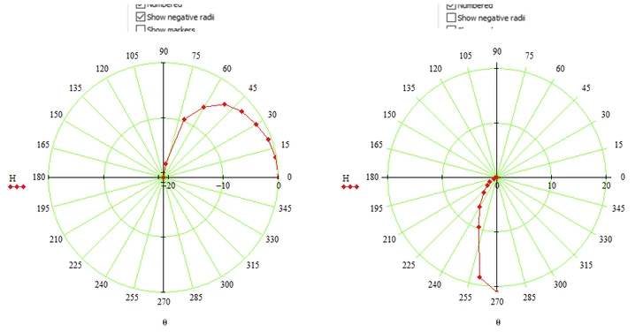

This is a very elementary question, but I cannot find a solution. I have two columns of numbers, the first (angles) goes from 0 to 90 in steps of 10, but I plot them in radians. The second  column is the measurement result at each angle, i.e. 10 values, the first being zero and the others are negative values down to -21. When I try to make a polar plot, I get the measurement values plotted in the 240 to 270 degree sector, and the radial axis goes from 0 in the centre to +21 at the perimeter.
If I try plotting in degrees, I get a bizarre scatter plot over the whole circle, but only 7 points are plotted.
How can I plot these data correctly?

There is nothing attached to your post.
But take a second look at my picture!
1) ALL 10 points are plotted and I even marked them with dots
2) Look closely at the radial scale! Because I checked "Show negative radii" the scale runs from -21 at the center to 0 at the outside. You can change those values at the appropriate placeholders at the right of the plot.
If you turn off "Show negative radii" (which is the default setting), the radial scale runs from 0 in the center to +21 at the outside. And of course the value of -6.2 for 60° is seen in the plot as +6.2 at 240° (the extension in negatives of 60 degrees).
This is shown below in the plot on the right side.
If none of these is what you expected, can you show which kind of plot you'd like to see with the data provides.

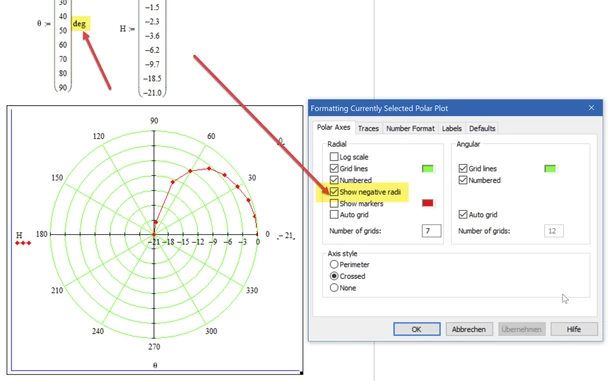

It looks like you are inputting the data in radians not degrees. you need to multiply f by degrees then convert to radians.
Thank you, but that doesn't resolve the issue, as you can see from the
attached.
Would this help
Instead of adding deg in the definition of theta you might write theta*deg in the placeholder of the plot.
Even though the polar plot shows angles in degree, angles in Mathcad always are in radian unless you explicitly state that the value are degrees.
