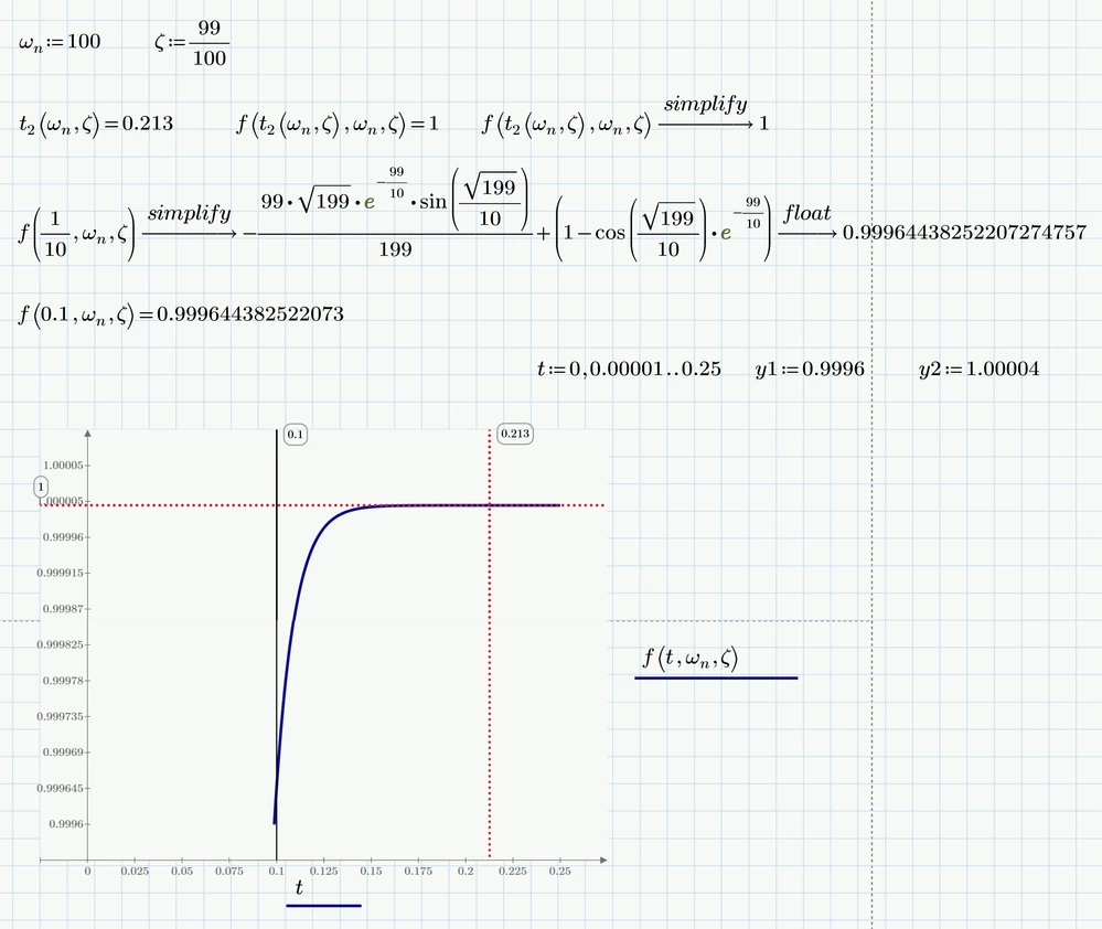

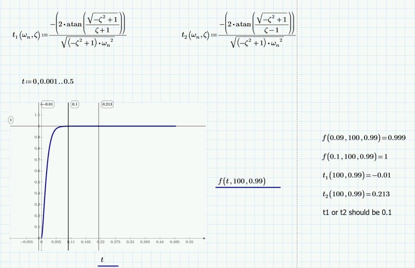

I have this equation:
I want to find time t (a symbolic expression for t) at which the above function is equal with 1. So:
What I am missing?
Werner_EAnswer
Aug 22, 2024 7:59 PM UTC
I don't see any problem here and don't understand why you think that t=0.1 should be a solution - it isn't.

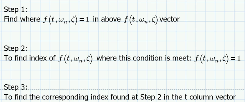

Now going also to an numerical approach solution for this problem. How to find t2 value above obtained by symbolic means way that gives f(t2(), , )=1?
For example one method at which I am thinking by now (but also other approaches are welcome): to iterate time t and then to look/check where f() have the desire value, in this case 1.
How to implement below things?
For this we need to check in the f() where f() = 1:
Then:
And finally to find the corresponding index found at Step 2 in the t column vector.
But as I said, other methods to achieve this thing (of finding time t at which f() is equal with 1) are welcome if exists. This above method is only at which I am thinking by now.
23-Emerald V
Aug 23, 2024 7:55 AM UTC
Have you tried the root() function?
