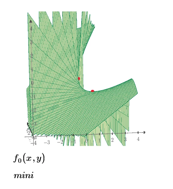

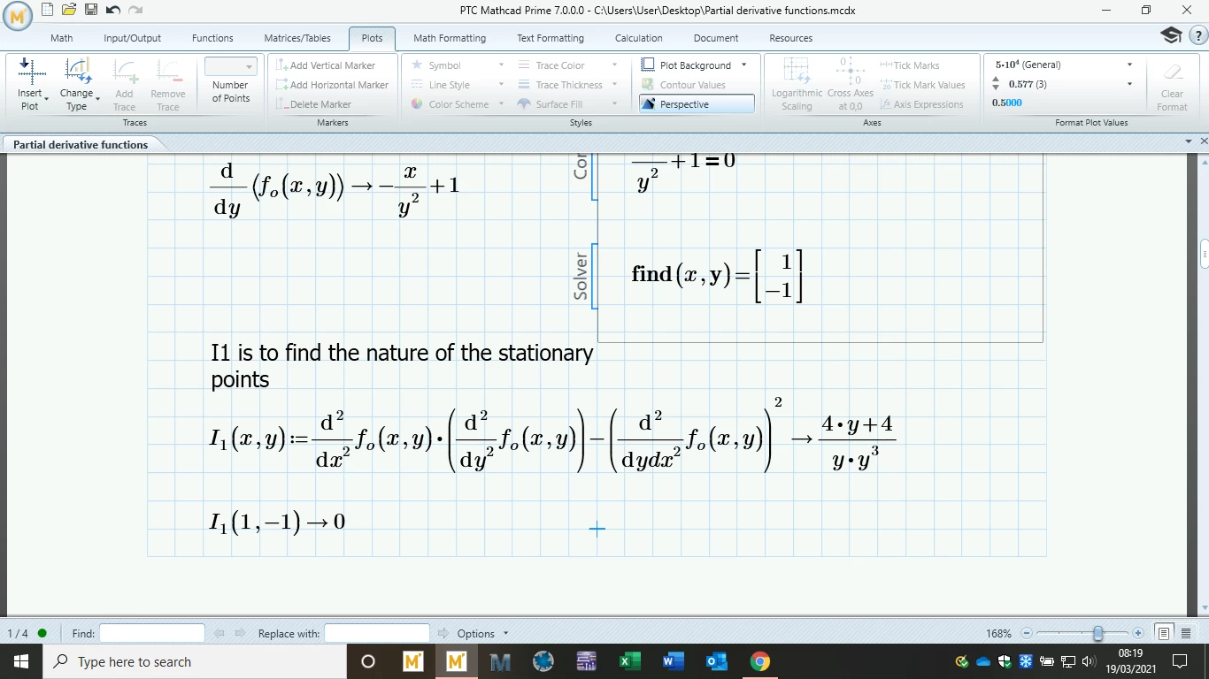

I am working on finding the stationary points of function of several variables f(x,y).
Problems:
1- How do I solve a system of equations without knowing its guess values? I took me a while to get the values x=5 and y=10 otherwise the equation solver does not work.
2- It seems that I have inputted the equations wrong to find the nature of stationary points ? Can anyone give me advice or tell me why is this not working? So, I1 should be a negative number(I think)
The correct answer is: a saddle point at (1,-1) [according to the maths textbook]
(Update: problem 3: how do solve an equation that has more than one solution? when I used solve block it only returns one solution)
Please have a look at my worksheet.

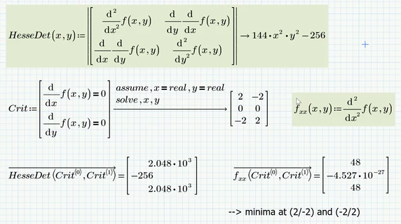

Werner_EAnswer

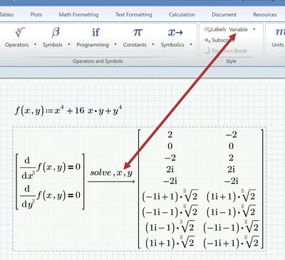

Primes infamous auto-labelling feature often is more a PITA than helpful.
You have to manually label the variables after "solve" to be "Variable" and NOT "(-)" (automatic).
And in case you are not interested in the non-real solutions, you may add an appropriate assume modifier:
If you make f an additional argument of "HesseDet", you may use this very same function for any of your given functions without having to redefine any more.

Thanks for the reply!
Why does it not work when I use the formula shown in the maths textbook? So, saddle point should give an answer less than zero in that equation in the screenshot.

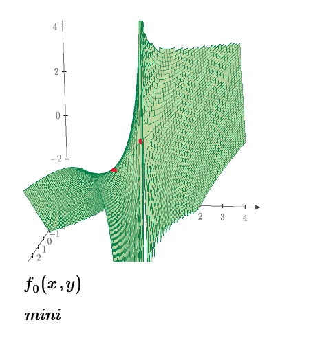

ttokoro
The saddle point  is [x,y,z]=[1,-1,-1]   Another point is [0,0,0], which is left above, is not saddle point,
