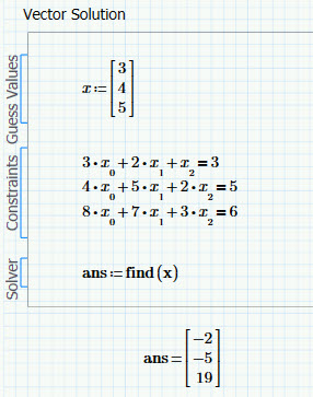

It's not a limit on the number of variables, but on the number of arguments you are allowed to enter. Combine some or all of the variables into a vector.

When I am typing in my variables to find in the Find Function, when I try and type in my 51st comma it will not respond.
RichardJ19-TanzaniteAnswer
November 29, 2016
November 29, 2016
It is more likely a limit on the number of arguments in the function call. Try combining the variables into a vector (so instead, of x and y, x[0 and x[1, and solve for x)

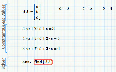

So, I have a huge 'find' equation where combining variables into vectors would be advantageous.  Following your advice, I can replace everything with subscripted variables.  Nice, but that makes the equations awfully hard to read since everything becomes x[0, x[1 instead of Pressure, temperature or whatever.    Here's what I got to work based on your advice.
My question is if there is anyway to stick with the native variables in the equations?  Something like this is what I'm after, but never seems to work (no solution found).
Thanks, (3.1 attached)
December 5, 2016
This works in Mathcad 15:
I haven't tried in in Prime.
