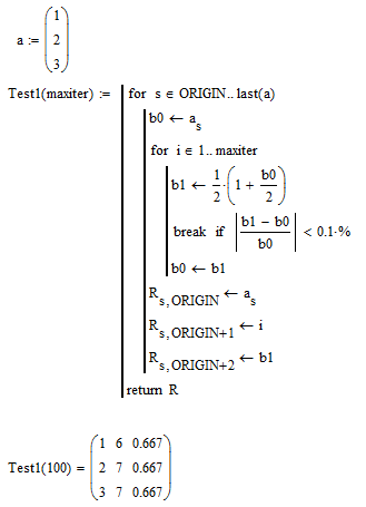

Hey guys,
i would need a recursivic calculation with a break condition. I made it so far but now i would need an extention to this calculation.
I added a mathcad file in which i described my problem.
I hope that someone can help me 😃
This is only an example but is describing my problem very good
Best thx!

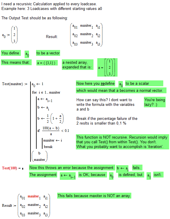

March 28, 2016
It's not completely clear what you want to accomplish. Here some first comments:
23-Emerald V
March 28, 2016
Is this what you are looking for?
March 28, 2016
Really? Not in my eyes.
First, all I see is a somewhat strange iteration, no recursion!
You write, that you don't want to write the formula with a and b - what do you mean by that?
In your example, you first define a as 1 x 1 vector, then, by a <- a[i you make it a scalar and immideatly after that you use it with an index as if it still would be a vector. THis throws the error.
If you replace every a by a[i your prgram works, but a[i never gets a new value, all a[i equal to 1 and so b is always calculated as 0,75 and as 0,25/1 is never smaller than 0,1%, you never reach the break command.
So its unclear to me what you are trying to do.
Also absolutely unclear is, why you expect a 3 x 3 matrix as result. Your routine just returns a 2 x 1 vector.

March 29, 2016
Thx for the fast help so far!
I think i am confused with the the meaning of recursivic.
I think i only need a normal iteration.
I try to explain a second time for better understanding.
I have a Input Vector.
Example: Force [100N;200N;300N]
For Every Force i need a separat Iteration with well defined formulas. Here just for simple: 1/2*(1+Force/2) and a breaking condition
The Resulting matrix should then be the INput force (here 100N;200N;300N); the last iteration step before breaking condition and the Result of the Iteration.
In the upper example instead of Force (100;200;300); the vector a is given (1,2,3)
So it is a normal iteration calculation, applied to every row of the input Vector until breaking condition
One last question: Do i need a vectorising operation when im doing a complicated calculation for b1?
Thx all for help
@FM thx for your file
For me its important to get the resulting value of the last iterationstep from every row of the input vector. (As to say the maximum needed iterations are different, depending on the input vector.
Here: a0=1 a1=2 a3=3
So far i have a problem to realise the calculation 😞
Maybe somone can give me a tip.
Regards!

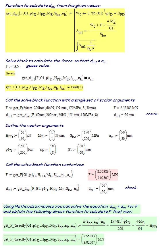

It looks to me that you can much better achieve what you are trying to do using a solve block!
April 15, 2016
I guess there is an easy answer to your question.
The only value which is changed in your routine is F by a constant of 1kN in every step.
So simply return F.new-1kN to get the value you want.
You can always re-calculate d.m1 with this Force to verify the condition d.m1 <= a.m
WE
April 15, 2016
OK, as I don't like the way you use your vectors directly in your calculation routine - here is a solution using a solve block.
Its always better to set up all calculation (no matter if iterations, programs, solve blocks, ..) to work for single scalar arguments and and only later call them vectorized with your vector arguments to get the results for a bunch of values with one call.
As the equation a.m=d.m1 can easily be solve symbolically, I also attached a function for direct calculation.
WE

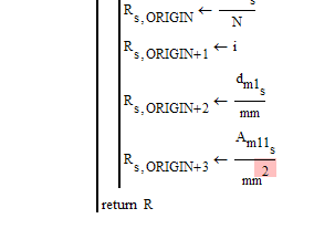

Thx for your help....
I solved it that way because i need to write much more complicated input....
here are 2 examples i finished so far.
But i still i have a failure on here 😞
I think the problem is the condition and the Number "1" in the routine
Maybe you can help me out another time
Thx
Still trying to understand your post.
The problem is that i have more than 20 input variables. This is only the beginning of the iteration (see my postet files)
I think i should have testet the program while writing regularly
April 15, 2016
I see, but nevertheless I guess its better to create functions depending on 20 arguments and call them later vectorized than to deal with the vectors from the very beginning.
This has nothing to do with the question if a solve block could do the job better or not.
Working with named functions is one of the benefits of Mathcad once you have accustomed yourself to them.
The problem in your file is here:
And isn't a minus sign missing here in front or something else? Your condition as its written means asking if A.m1[s equals 1/3 a[2
