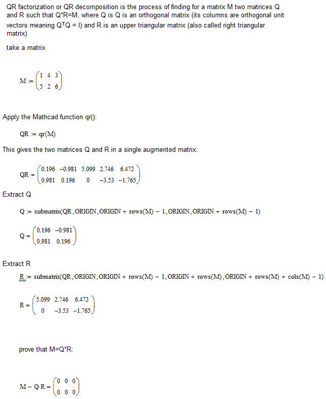

Like this?
Try and play with it by modifying M (not only its values, but also its size and shape.)

Hi Luc,
Thanks for responding. I appreciate your effort but this doesn't quite answer my question. I am able to do QR factorisation using the Mathcad function provided but I need to do RQ factorisation, which is a slightly different factorisation that gives different ‘Q’ and ‘R’.
As you demonstrated, “QR factorisation” of a matrix A gives two matrices, say B and C, such that A=BC where B is an orthogonal matrix and C is upper triangular.
But “RQ factorisation” of a matrix A gives two matrices, say D and E such that A=DE where D is upper-triangular and E is orthogonal.
Matrices B,C,D and E are generally all different.

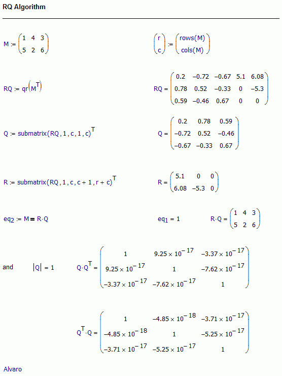

Hi John. Hope this helps. But not very sure if you need to reverse R (or eventually Q too) because my R is lower triangular. There are some few variants for this algorithm. But what actually is important, is that:
  • QR is Gram-Schmidt orthoganilization of columns of A, started from the first.
  • RQ is Gram-Schmidt orthoganilization of rows of A, started from the last.
Also in my example, Q'*Q = Q*Q' = identity, and I know that for Q'*Q this is not always desiderable. Finally, notice that I use Origin = 1.
Best regards.
Alvaro.

Thanks Alvaro,
Unfortunately your soultion doesn't perform "RQ" factorisation as it is generally defined.
As you observe, it provides a factorisation into a Lower Triangle and Orthoganal matrix pair.
Anyway, I have now figured out how to do this and I have attached my solution to this post.
Best Regards
John
