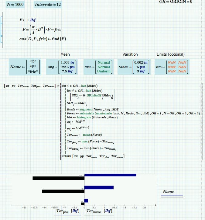

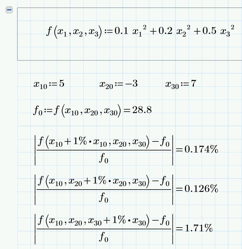

can I perform a sensitivity analysis with Mathcad Prime 4.0? As a result I would like to know which parameter has the greatest effect on the Output. There are local and global sensitivity analysis. At local sensitivities, only one parameter is varied and all others are kept constant. Globals also indicate the interaction between the Parameters. Or maybe there is another oppurtunity.

With the exception of the Uniform distribution issue I mentioned earlier, it looks to be working fine.  M truly dominates the equation with its large variance.  Or else point me to a specific issue you're seeing.

There are multiple ways it could be done.
a.) programming as Werner suggests.  Perhaps the most robust of the solutions
b.) Redefine one variable at a time as a random vector (runif works well) and vectorize any equations as necessary
c.) built in montecarlo function.  You can change each variable's standard deviation individually.  Make stddev zero for all but one variable and see how the output changes for each one.

Maybe something like this

I came up with this to make a tornado graph (and histograms) from a monte carlo.  The monte carlo is run several times, wherein only one variable is allowed any deviation at a time.  Not the prettiest graph, but gets the job done.  (Simple calculation looking at force output of a piston where the variables are diameter, pressure and friction)
4.0 attached
