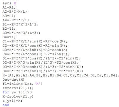

solving numerically the frequency and mode of the problem
Dear forum
In Euler-bernoulli theory, I am solving numerically the frequency and mode of the problem in which both ends are supported by springs in the vertical sagging of beams. Through this, the mode of the continuous beam is intended to be represented as a picture.
In the paper for reference, the angular frequency was calculated using MATLAB's system variable 'K' and "Inline function".
MATLAB from reference.
reference) Impacts of various boundayr conditions on beam vibrations. Ye Tao, 2015
My code is as attached.  I need help on how to implement this with MATCAD. When trying to implement using MATHCAD in the same way, it is difficult to solve the equation using a function and find each solution as the number of frequencies increases. Inquire about how to apply the function to this.

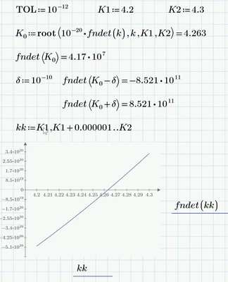

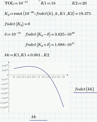

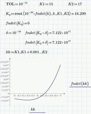

23-Emerald I
Nov 27, 2023 1:58 PM UTC
You've run afoul of Prime's dreaded labels problem, some of your K's show as bold blue--Prime thinks they're a unit rather than a variable.
You can plot the determinant of a matrix for each value of K, then solve for the roots of that equation.  Example in P9 attached (without roots.)

6-Contributor
Nov 28, 2023 1:38 PM UTC
Thank you very much for your response. I tried to apply the method of giving a specific range and solving the solution like your method, but I still think we need to organize more to apply the method of doing the harm and solving (understood like the false position root finding method) like the attachment.It is still difficult to find the determinant, and to find the value for each mode.
