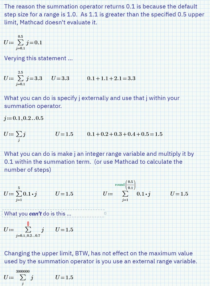

HI,
Could someone explain to me how to calculate the summation operator? I have attached a picture where you can see my formula. If I understand correctly, my condition formula should work like this: 0.1 + 0.2 + 0.3 + 0.4 + 0.5 = 1.5. However, Mathcad only gives 0.1. What am I doing wrong?

Ignore my previous suggestion.  While on my back home, I had a "Doh!" moment.  I'd temporarily forgotten that the Summation Operator automatically steps by 1.   I would suggest that the j specification needs to include the step value, but I can't figure out how to include it.  Hopefully, somebody will be along to say how it can be done.
In the meantime, however ...

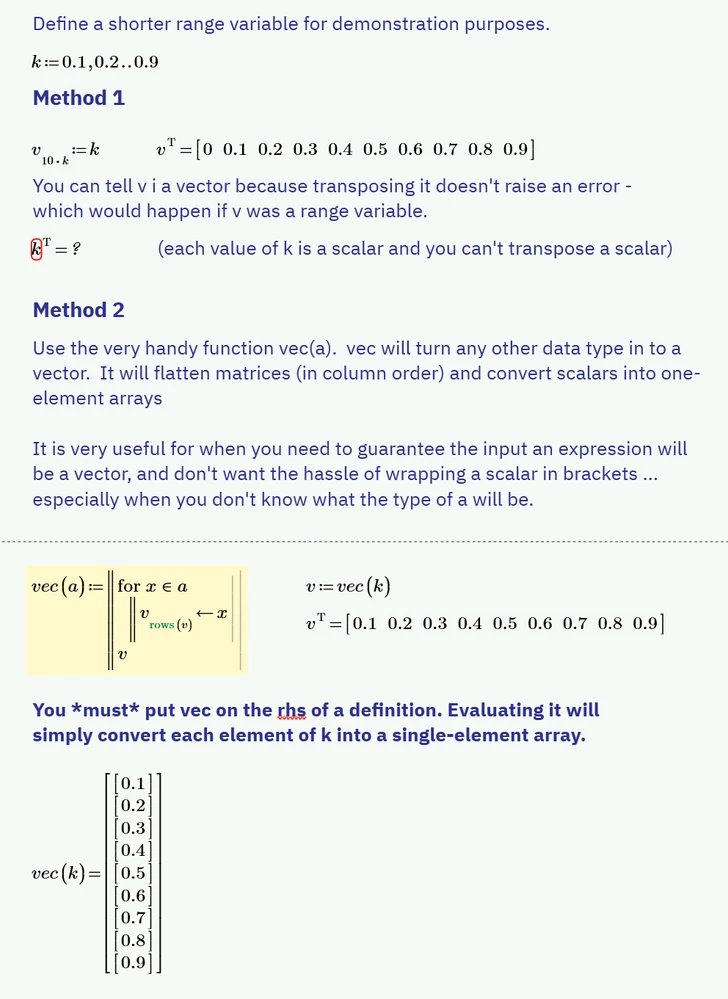

By the same token, do you know how to get the number of rows from the matrix t? I tried using the rows(t) command, but it doesn't work, and I can't find another way
23-Emerald V
Sep 28, 2024 9:51 PM UTC
t is a range variable.  A range variable holds a range definition (range operator with values).  A range variable is effectively a promise to generate the specified numbers one at a time when the rv appears in an evaluation (=) or the right hand side of a definition (≔).
It is NOT a vector.  Range variables and vectors have been confusing new users since time immemorial precisely because they look the same.
Note that you need to be careful using Method.  Because Mathcad, like most maths apps, uses (64-bit) floating point arithmetic, you can have small internal differences from the exact decimal representation of a number.  So, scaling might not give the desired exact multiples of a number. It is sometimes best to use a rounding function (eg, round!) to avoid potential issues).
There are other methods of converting, and I'm confident somebody else will be along to show them (I always use vec and have it in my default template, so I don't need to rewrite it every time or copy/paste it).
