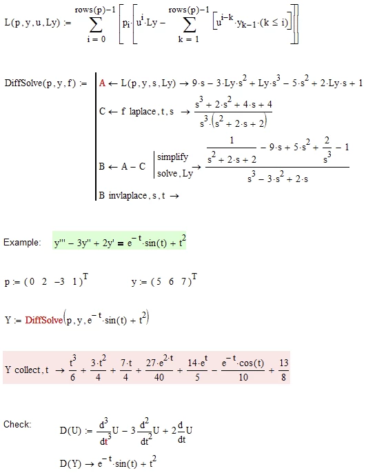

I guess the book you referred to is "Calculus and Algebra with Mathcad" by Byrge Birkeland. There was a version of the book for Mathcad 8 from 1999 and a later version for Mathcad 2000. Not sure if the MC8 version already included that chapter (4.3.2).
Anyway, here is a modified version of the described method which also works in Mathcad 15 (it will not work in Prime). As in the original version, the independent variable must be called "t" - this is mandatory!

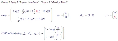

Given the right version of Mathcad (11), and some tweaking:
But all this is unsupported.

Heureka! Persistence sometimes pays off!

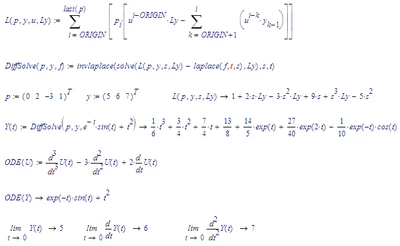

Great!
In Mathcad 11 the construct with k<=i fails. As soon as I put that in, the function L forgets about the initial conditions, they're all set to 0.
Since its use is to limit k from going above i, this can also be accomplished by the upper limit of the inner summation. I also observed that the L function is not ORIGIN aware.
It appears that I can compact the DiffSolve function to a oneliner.
The result is:
September 4, 2020
The one liner sure is possible only in MC11 but not in MC15.
The construct with *(k<=i) is necessary in MC15. I am not sure why, but the symbolic in MC15 seems not to like the "i" as an upper limit of the second sum.
The error message when trying to symbolically evaluating L(..) is "assumption impossible (property::Null)" ????
Otherwise your implementation would sure be more elegant and preferable. And yes, I agree that L should be written ORIGIN-aware 😉

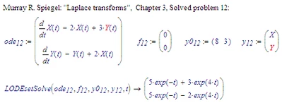

September 27, 2020
It's done:
Now neat it up and transport to Mathcad 15.

@Werner_E
Can you check if this works in Mathcad 15 with similar results to Mathcad 11 (pdf attached).
If it does work, please save both files as .xmcd.
October 1, 2020
Unfortunately ODE systems don't work. The error message is an less helpful "pattern match exception".
