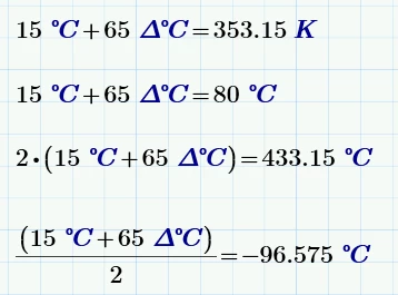

Today the outside temperature is 0 °C, tomorrow it will be twice as cold. What is the expected temperature tomorrow?
What do you want to double, or cut in two?
You need to understand that Prime's unit °C is 'sort of an absolute temperature': internally it is converted to K (Kelvin). The unit Δ°C on the other hand is a relative temperature, or temperature difference. The value of 1 Δ°C is exactly the same as 1 K. (ISO standards regarding usage of units prescribe that only (!) K should be used for temperature differences.)
When you want to double a temperature in °C, you probably want to double the part of temperature that lies above 0 °C. Hence you would write 0 °C + 2 * 15 Δ°C when you want to double from 15 to 30 °C.
And of course, the better (complying with standards) usage is: 0 °C + 2 * 15 K.
All this still doesn't answer the question at the top, but hopefully it helps you.
