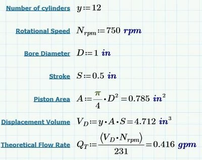

I am in school and trying to work through this example in the book. It all works out except the Theoretical Flow Rate which the book specifies as 15.3 GPM. From a little research I believe the issue is with how MathCad defines rpm but I can not figure it out. Capture.JPG
Any help would be greatly appreciated,
Frank
Best answer by DJF
Don't divide by 231 - Mathcad knows units so it's going to do that on it's own, you're forcing it to do it twice.

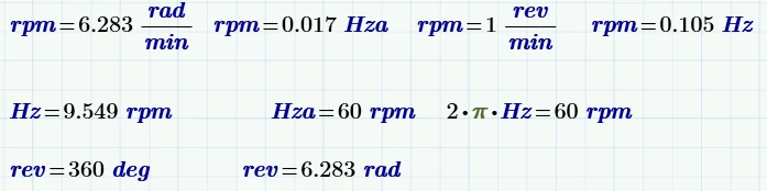

Also, you have a unit of revolution in your input but none in your output.  So, Mathcad is going to divide by 2*pi to get rid of it.  Dealing with anything rpm related can be tricky.
So without the 231 and 2*pi factors you get the expected answer.

I greatly appreciate your answer. I was able to exchange the 231 with 2*pi and get the correct answer. I researched and now understand the 231 portion because that is converting in^3 to gallons which Mathcad does through its unit conversion but I must admit I still do not quite understand the rpm (2*pi)portion. Thanks again for the assistance!
23-Emerald I
December 21, 2018
rpm should be considered "revolutions per minute", there are 2 pi radians per revolution, so you needed to correct for that
