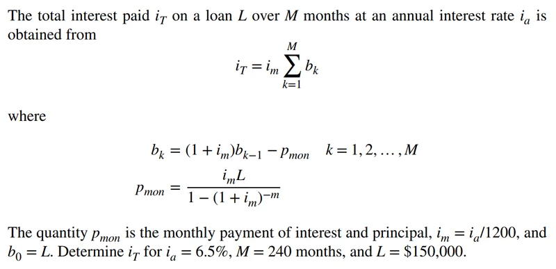

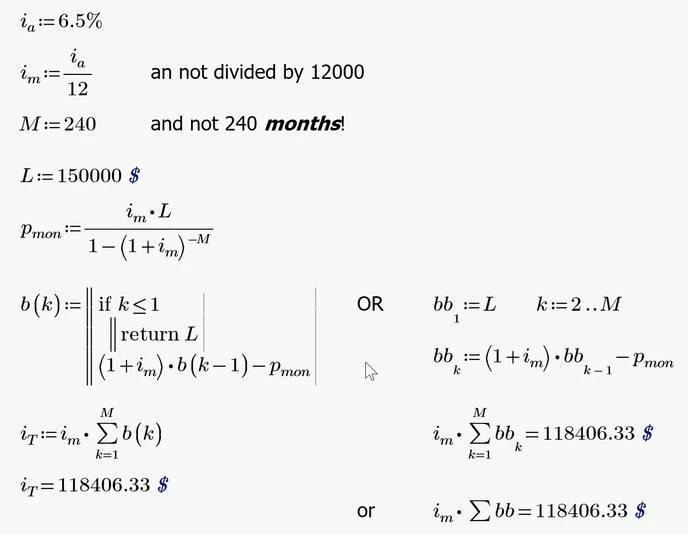

Sep 24, 2024 1:11 PM UTC
M=240 months is wrong! M is not a time, it has to be just a number (possibly numbering the months).
In the formula for "p.mon" the definition of "m" in the exponent is missing.
Cornel19-TanzaniteAuthor
Sep 24, 2024 1:33 PM UTC
Yes, its the numbering/number of the months for which the load was made.
From where I took the problem its not written either there. But from my interpretation is like that:
Sep 24, 2024 1:57 PM UTC
My point was merely that the information is garbage, as is unfortunately very often the case in so-called economic “science”.
If a quantity is dimensionless, then you can't assign a unit to it in the text either.
And if you use a variable “m” in your explanations, then you also have to say what you mean by it.
Simply replacing “m” with a “k” would be too short-sighted, you would just have to express that p.mon is dependent on “m” - in mathematics this is called a function 😉
In the formula for b.k you can then use the running variable k as a function argument.
But actually its just a typo and "m" should be "M" !
See my answer below.

Sep 24, 2024 2:52 PM UTC
@DJF wrote:
There are of course built-in finance functions within mathcad and excel.
Yes, that corresponds with the formula given if we replace "m" by "M" 🙂
